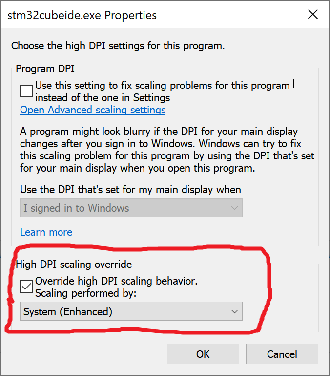

If you set Compatibility -> High DPI Settings to override and System (Enhanced), things work fairly well. You'll probably need to undo your other changes. This can be found by right clicking on the program icon and going into properties.
Edit: this is for Windows.

Sorry, I've forgotten to write: I'm using STM32CubeIDE under linux (Ubuntu-20.04-64). It does not know anything about such settings...
