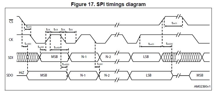

Well, because I had some issues debugging the old project that I built with GCC/AC6 toolchain, I had no way to find what's going on on the registers level. I just managed to build a new project based on the SPL 1.7 with uVision so I can debug and see what's going on. I noticed that the RXNE flag is never set, although I'm getting the data back from my slave without any problem.
Anyways, as far as the SPI Communication is concerned here, and from what I understand, the device goes inactive when CS forced high, which puts the SDO (MISO) in High Impedance state. According to the datasheet of the device, the communication starts when CS is forced low and the output (SDO) is latched on falling edges of the clock. This is shown also in the following timings diagram:
As you can see, CS is forced high for certain time (tdisCS) then low again to start the reception of data. This is how the SPI is supposed to work across all similar devices. Even the CMSIS implementation for SPI follows the same rules for sending/receiving. But, what I don't understand here is the following function that is still doing the job and getting the response back from the slave. I just don't understand how the response byte is being shifted or read back from the device, while the CS is forced high? This is the function:
uint8_t dSPIN_Write_Byte(uint8_t byte)
{ /* nSS signal activation - low */ GPIO_ResetBits(dSPIN_nSS_Port, dSPIN_nSS_Pin); /* SPI byte send */ SPI_I2S_SendData(dSPIN_SPI, byte); /* Wait for SPIx Busy flag */ while (SPI_I2S_GetFlagStatus(dSPIN_SPI, SPI_I2S_FLAG_BSY) != RESET); /* nSS signal deactivation - high */ GPIO_SetBits(dSPIN_nSS_Port, dSPIN_nSS_Pin); return (uint8_t)(SPI_I2S_ReceiveData(dSPIN_SPI)); // Here the response is read while CS is forced back to high. }Could someone elaborate more on this? How and when the response byte is supposed to be shifted out of my slave? And how the SPL-based function above returns the response from the slave device (dSPIN) while the device is ''UNSELECTED'' by forcing CS High??
