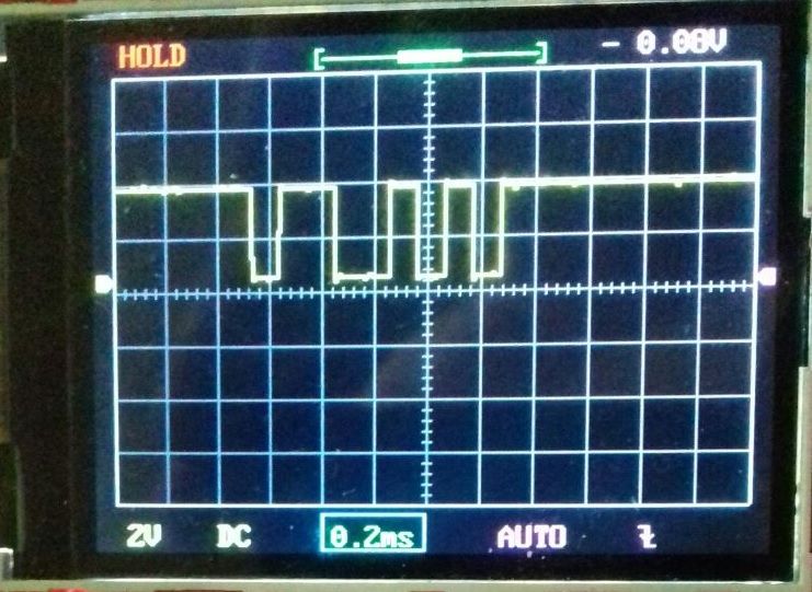

    I'd probably make sure the GPIOA clock is enabled, assume it must be some place else if you see pin signals on scope.
    Signal looks reasonable enough for 0x53 01010011 'S' at 9600 baud.
    Is the Transmit from the STM32 connected to the receive pin of the receiving device.
    XBee radio link involved in the connectivity?
    rtek
    rtekAuthor
    March 23, 2018
    Posted on March 23, 2018 at 19:18
    So the TX pin is alive. Here's a scope from just sending a letter ''S''. Looks about right doesnt it? Why doesnt the FTDI232 or Xbee react to this message then?
