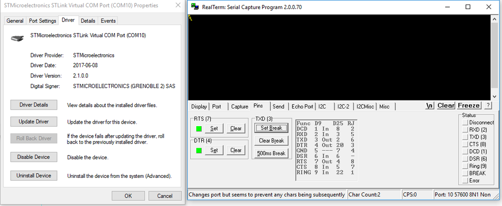

Hello!
Is it possible to send a UART break (0.3 seconds) over the Virtual COM Port.
It seems that UART break is connected with NRST.
-Thomas
Posted on January 29, 2018 at 16:08
So, if you want the BREAK to reach the target STM32, you'll have to use a separate connection direct to the target's UART pins (and break the links to the ST-Link UART if you want to use those pins)

T B
Posted on January 29, 2018 at 13:45
PC --> STM32 (The STM32 resets.)
On the PC I generate the break with RealTerm or with pyserial. Both has the same effect.

Posted on January 29, 2018 at 14:56
I have tried it on the STM32F3DISCOVERY and NUCLEO-F302R8 boards. Both have the same behavior.
If I press ''Set Break'' in RealTerm'' then PIN T_NRST (PB0) of the ST-LINK MCU (U2) assert low and
