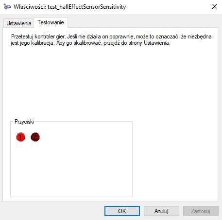

Hello, dear community!
I have a problem with adding more than one button to my STM32 Button Box / joystick with buttons. I am using USB HID.
I made it as simple as possible - only two buttons, simplest descriptor. The problem may be trivial, but after 4 days and ~8 hours per day - I can't find solution. I watched most of the STM32 USB training course (on yt), I was digging deep in st forum and google/bing/yahoo, but nothing helped. I think there is not a ready answer to my problem in the whole internet.
About the problem: One button (the first one) is working flawlessly, but when i try to USBD_HID_SendReport for another button - nothing happens.
My descriptor:
// HID Report Descriptor
0x05, 0x01,        // Usage Page (Generic Desktop)
0x09, 0x04,        // Usage (Joystick)
0xA1, 0x01,        // Collection (Application)
0x15, 0x00,        // Logical Minimum (0)
0x25, 0x01,        // Logical Maximum (1)
0x75, 0x01,        // Report Size (1 bit)
0x95, 0x02,        // Report Count (2 buttons)
0x05, 0x09,        // Usage Page (Button)
0x19, 0x01,        // Usage Minimum (Button 1)
0x29, 0x02,        // Usage Maximum (Button 2)
0x81, 0x02,        // Input (Data, Var, Abs) - Button states
// Padding to align to a byte
0x75, 0x07,        // Report Size (7 bits, for padding)
0x95, 0x02,        // Report Count (2 bits for padding)
0x81, 0x03,        // Input (Const, Var, Abs) - Padding byte
0xC0               // End Collection

And how it looks in windows gaming devices (sorry for non-english screenshot, but I think you'll get the point. Button1 on, Button2 off):
Summary: Descriptor - works, device is properly recognized as 2 buttons device
button1 - works as intended
button2 - does not work and this is my problem

liaifat85
Senior III
You should update the joystickHID struct to match the HID descriptor. Change the button1 and button2 variables from uint8_t to uint8_t buttons so it fits in a single byte. The updated struct should look like this:
typedef struct {
uint8_t buttons; // 2 bits for buttons, 6 bits for padding
} joystickHID;

I implemented your solution, but now not a single button can be activated. Of course i tested it with my input sensor in GPIOA PIN1 and GPIOA PIN2

I managed to fix the problem with bitwise operations used to send data. The problem was in the
USBD_HID_SendReport(&hUsbDeviceFS, (uint8_t*)&joystickhid, sizeof( joystickHID )); // send usb report with buttons states
I changed the LEN value of  USBD_HID_SendReport from "sizeof( joystickHID )" to "2"
USBD_HID_SendReport(&hUsbDeviceFS, &joystickhid, 2); // send usb report with buttons states
Now it works as intended with two buttons. Descriptor was not changed at all.

And left my code as it is (to test if the first two buttons will still work). Aaand this two buttons stopped working.
I think the problem still lies somewhere between USBD_HID_SendReport and/or descriptor, so first I tried to play with different USBD_HID_SendReport LEN values:
USBD_HID_SendReport(&hUsbDeviceFS, &joystickhid, 1);
USBD_HID_SendReport(&hUsbDeviceFS, &joystickhid, 4);
USBD_HID_SendReport(&hUsbDeviceFS, &joystickhid, 8);
USBD_HID_SendReport(&hUsbDeviceFS, &joystickhid, 16);
Success was not achieved yet.
What is wrong with my code?
HA!
I think I found the solution!
Proper USBD_HID_SendReport values for my project are:
USBD_HID_SendReport(&hUsbDeviceFS, &joystickhid, 9);
First problem was solved thanks to liaifat85. Thank you liaifat85.
Summary of solution for first problem: You can send button states for multiple buttons using only one variable (applies for up to 8 buttons, haven't tested no solution for more buttons, probably will in the future).
Second problem was indeed lying in the USBD_HID_SendReport  LEN parameter.
As it turns out, you have to specify right LEN parameter for USB HID to accept SendReport (now it is obvious for me, it wasn't few hours ago). In my case i had descriptor with values:
0x75, 0x08,        // Report Size (8 bits, for padding)
So you have to add Report Size and Report Size padding. 8+1 = 9
Summary of solution for second problem: You have to use proper LEN parameter for USBD_HID_SendReport. When you use Report Size of 1 and Report Size padding of 8, you want to send 8+1, so proper value for USBD_HID_SendReport LEN will be 9.
I hope my pain-filled journey could help any soul in the future.
Regards.
