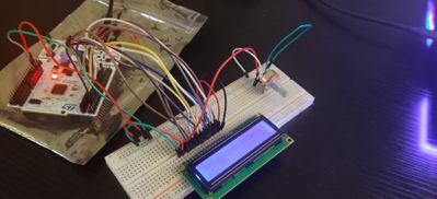

Hi all,
I need help. I am using the STM32-F446RE Nucleo-board and I have it connected to a 1602A LCD display. I am trying to write "Embedded" on the first row and "Systems" on the second row, but I get it all in row 1. Can someone look over my code and let me know what I am doing wrong? I have attached pictures of my physical connections and code. Thank you.

Hello
It is possible that your delay is optimized away since it is empty loop. Try put some code to loop
https://stackoverflow.com/questions/70907142/delay-implementation-in-stm32-using-for-loop
Or maybe call HAL_delay inside your delay- function.
Br J.T
Leo.94
Hello
It’s possible it’s the delay.
Try changing your code:
void lcdInitialize(void)
lcdCommand(0x38); // Configuring lcd in 16column and 2row format
delayMs(5);
delayMs(3);
lcdCommand(0x0C); // Display on, cursor off
delayMs(3);
lcdCommand(0x06); // Increment cursor
delayMs(3);
lcdCommand(0x01); // Clear screen
delayMs(3);
