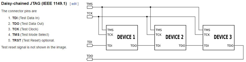

(3) Are TDO/TDI signals of programmer directly connected TDO/TDI signals (respectively) of STM32 MCU? Or do I need to cross the signals? For example, connecting TDO of programmer to TDI of STM32 MCU and TDI of programmer to TDO of STM32 MCU?
(4) Is the TRST signal required for programming? Or do I need just the nRST of programmer connected to nRST pin of STM32 MCU?
Following this image of the link bellow. TDO/TDI of programmer are directly connected do STM32 TDO/TDI (respectively), and TRST is optional (won't be used in my case).

Posted on April 29, 2016 at 20:16
1) Yes
3) Correct, directly connected as named, or with multiple devices chained as diagramed
3) No, but it can also be programmed with a subset of pins, and we haven't really ascertained why JTAG is important here vs SWD.
Do you have multiple  JTAG devices in a chain, do you do boundary scan?
