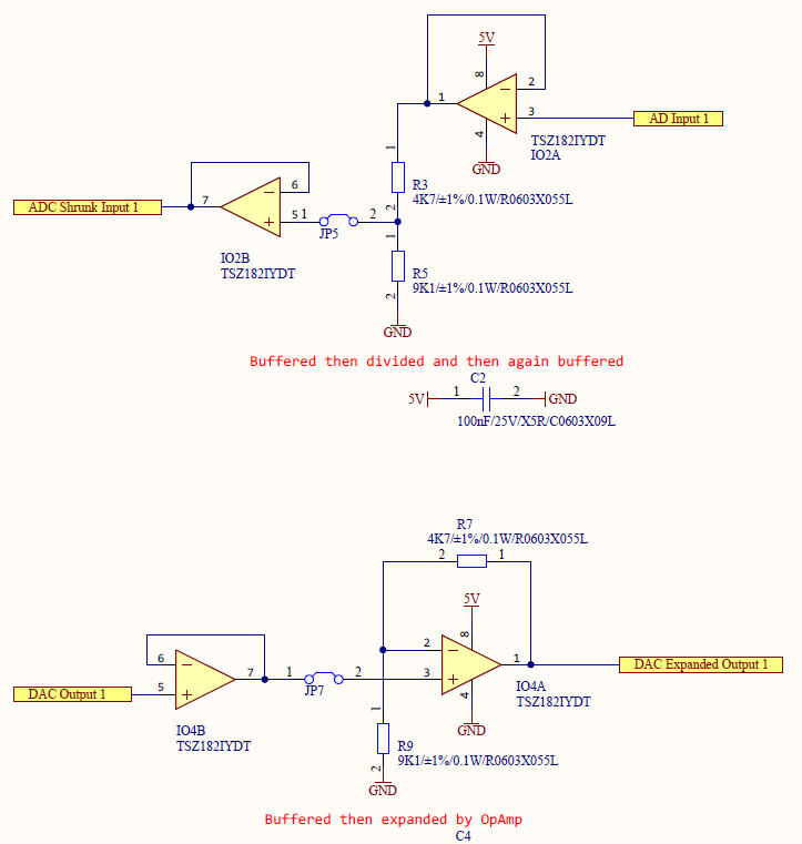

Hallo everybody,
i would like to generate analog signal (0-5 V) via DAC but the problem is the maximam voltage is 3.3 V . ist it possible to change some configuration to generate an analog signal with maximam voltage from 5 V?

Use an external op-amp to scale up the voltage range..
Same for the ADC.

And you definitely need an output buffer amplifier to get 5V.
Mind the DAC output impedances and the offset voltages associated with the DAC buffered/unbuffered configuration options.

There is no sw solution for 5v analog output unless using scaling external hw
