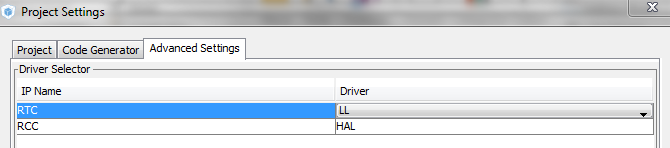

If you need to generate initialization code for RTC based on LL driver, you have just to select ''LL'' for the RTC configuration generated code (Project >> Settings >> Advanced Setting):
Then, depending on RTC use case, you may add the control functions.

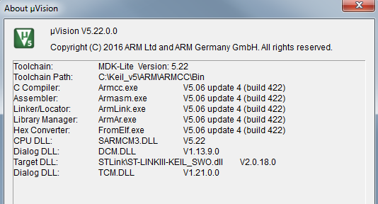

Posted on March 06, 2017 at 09:22
Hello again,
I tested with the version of Keil I have :
and I use the STM32L431RCTx MCU with RTC set to LL.
And it compiles correctly in Keil :
*** Using Compiler 'V5.06 update 4 (build 422)', folder: 'C:\Keil_v5\ARM\ARMCC\Bin'

It would be easier to help you if you give us all the input you have when you encounter your issue.
If your issue still occurs after verifying that Keil supports the MCU you are working on, please provide us your ioc, keil version, CubeMX version...
