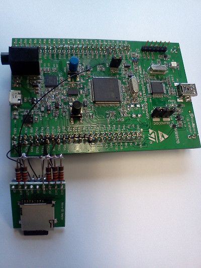

i have a small problem i think.
With the help of this forum and google i created a project with CoIDE.
What it should do is reading the directory of an SDCARD.
The SDCARD part is working. but the fatfs is not working and i don't know what i'm doing wrong.
I believe everything is oke.
so i hope someone could help me.
I attached the whole project.
#sdcard-stm32f4-sdio-fatfs

I've tested something materially identical in Keil. This appears to be hard faulting. Perhaps it doesn't like the stack in CCM.
And no it does not write to the card.
My primary platform is a custom F2 board, I have a MicroSD card tied to the STM32F4-Discovery now, and that is working.

The GCC build is hard faulting, FsFat[_VOLUMES] is NOT being cleared by the C startup code, need to evaluate. Probably needs an ''= { 0 };'', although the comment seems to heap blame/ownership on the compiler.
The Keil based code is working.

I changed the source so it would perform some head-less operations so that it writes back to the card. I got there by standing up the code in a debugger (Keil in my case), and stepped about in the code to understand what was failing.
You could download a merge tool like WinMerge and observe the changes between the prior release and this. I'd say not that much, just small stuff that was critical.
In debugging it became apparent that my hard faults were coming from indirect accesses through memory that the FsFat software assumed were zero. I confirmed what the run time code was clearing, and then tried to understand why. I gleaned most of the information from the MAP file produced by the linker.
I also wire-wrapped up a breakout board that I picked up on eBay via Hong Kong so I could finally test on the STM32F4-Discovery instead of the custom board that already has a working MicroSD socket on the PCB.
