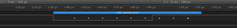

Posted on March 02, 2017 at 13:32
Ah, you've been caught by the rather non-conventional 'parity is last data bit' of the STM32 UART implementation...
On the waveform above, you've transmitted 0x40 0x0D 0x0A with 7 data bits and odd parity. Set the terminal to 7O1 and you'll see your transmitted data OK. Please do this just for the fun of it.
Then change the STM32 setting to 9 bits and you'll receive what you intended originally.

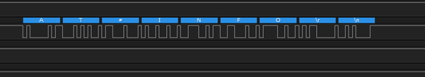

ra.pamod
Posted on March 02, 2017 at 11:47
ra.pamod
Posted on March 02, 2017 at 11:49
Fig.1. Transmitted from desktop to STM32F302RC controller.
Fig.2. Transmitted from STM32F302RC  to desktop.
Bit level I cannot not check,
But the frames sent from STM32 is not correct. Frames sent from Hyper terminal are correct. Frames sent from STM32 shows parity error on Analyzer. The frames from Desktop terminal are shown correct on analyzer.
Analyzer used is Salae logic analyzer.

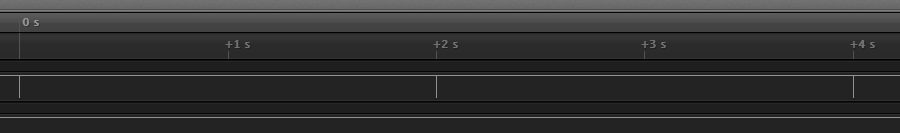

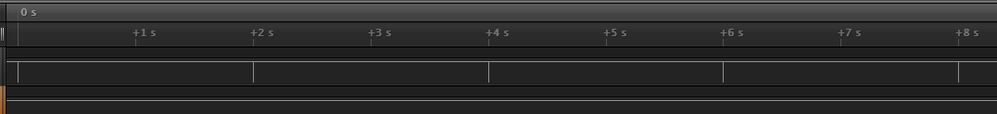

Posted on March 02, 2017 at 12:52
I am transmitting '@' every 2 sec as shown below without parity.
fig.1.
fig.2 expanded wave form of each byte.
Below is the wave form with even parity setting:
fig.3.
fig.4. expanded wave form of bytes with even parity
seen on desktop terminal in ascii format  ''Â�À''
In hex format as ''C0''
