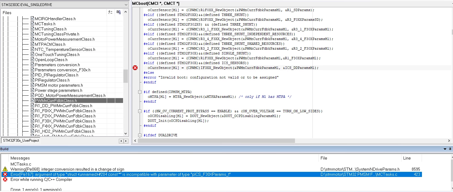

Hi, when I selected using two isolated current sensor in st motor control workbench. The IAR couldn't compile the code and gave the error
May i know is there a solution to the problem? But using 3 shunt resistor current sampling does not have such problem.

    It's a basic 'C' error - the type of the argument you've supplied does not match what the function requires.
    So look at the function declaration, see what type it is expecting - and make sure you give it something of that type!
    This is basic 'C' stuff - nothing specifically to do with ST.

    It seems ST have not finished their work on the ICS_F30X_PWMnCurrFdbkClass.
    Why release something half-done and then not clearly comment on this in User Manual UM1052/3 or in the code?
    Could someone from ST please adress this. F30X is a popular platform for motor control so it should be high on the list of priorities to maintain code for this MCU!

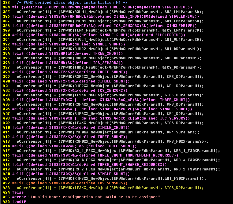

    Other classes for ICS current feedback uses a particular struct,ICS_DDParamsM1 initiated in SystemNDriveParams.h.
    This struct has of the typeICS_DDParams_t. Thus, for the F4 ICS class the function signature looks is this:
    CIF4XX_PWMC IF4XX_NewObject(pPWMnCurrFdbkParams_t pPWMnCurrFdbkParams,
    pICS_DDParams_t pICS_DDParams);
    and yes, this should then compile and run on a F4 MCU.
    For F30X however it seems that ST started development on it and have not finished. If we see the similar function signature for F30X:
    CIF30X_PWMC IF3XX_NewObject(pPWMnCurrFdbkParams_t pPWMnCurrFdbkParams,
    pICS_F30XParams_t pICS_DDParams
    Ok so there is a mismatch of types, leaving us with two options for a fix:
    1.
    Change the type for the the NewObject function
    pICS_DDParams_t
    pICS_DDParams
    2.
    There is a struct definition for
    pICS_F30XParams_t inICS_F30X_PWMnCurrFdbkClass.h howver no such struct is being initiated in SystemNDriveParams.
    I have looked at both solutions and are currently working on this. 1) fails because the init function of
    ICS_F30X_PWMnCurrFdbkClass requires fields in the structs that are not inpICS_DDParams_t. 2) I have not looked into yet, but initiating a struct of the correct type should be possible.
    Again, to me it seems like ST have started work porting ICS architecture to F30X, but left it unfinished like a complete mess. The UM1052 states that there is no support for ICS for F30X:
    Yet still the class
    ICS_F30X_PWMnCurrFdbkClass is a part of FOC SDK V4.3
    and in MCTasks.c we find:
