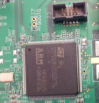

Mark Edwards
Posted on May 09, 2014 at 21:23
''I think that the STM32 range does not support JTAG. The full signals required to support JTAG are not listed in the pin outs (at least for the STM32F405 device that I work on).
The STM32 only support SWD.''
If this is correct how can the STM32F429 support boundary scan tests? Which doesn't work with SWD.
I haven't tried to use it myself yet, but hope to in the future.
From the STM32F42x Reference Manual:
38.5 STM32F4xx JTAG TAP connection
The STM32F4xx MCUs integrate two serially connected JTAG TAPs, the boundary scan
TAP (IR is 5-bit wide) and the Cortexâ„¢-M4 with FPU TAP (IR is 4-bit wide).
To access the TAP of the Cortexâ„¢-M4 with FPU for debug purposes:
1. First, it is necessary to shift the BYPASS instruction of the boundary scan TAP.
2. Then, for each IR shift, the scan chain contains 9 bits (=5+4) and the unused TAP
instruction must be shifted in using the BYPASS instruction.
3. For each data shift, the unused TAP, which is in BYPASS mode, adds 1 extra data bit in
the data scan chain.
Note: Important: Once Serial-Wire is selected using the dedicated ARM JTAG sequence, the
boundary scan TAP is automatically disabled (JTMS forced high).
Posted on May 09, 2014 at 21:29
Everything except the STM32F0 support JTAG and SWD
You don't get an RTCK (Return Clock), but this shouldn't be a problem.
JTAG is a standard, what individual vendors do with the scan chains inside their devices is obviously completely up to them.
If you want to know what VisualGDB does/supports, you'll need to talk to them about that.

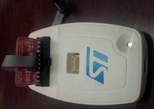

Generally speaking I'd recommend using the old 20 pin 0.1'' header, as practically everything will connect to it without magic cables. The 10 pin 0.05'' header is what we use for all our boards these days because it's significantly more compact, and new pods will support directly, or with a simple off the shelf adapter.
Try to avoid using custom headers, or the 5-6 in-line connector used by ST on the DISCO boards.

I think this makes more sense to me now.  (please correct me if I am wrong) There is the JTAG connectors that are on the boards and it is just that there are different versions of them, not that one is JTAG and another is something else because of the pin count.  The most common when dealing with dev boards (from what I see anyways) is the 20 pin, 10 pin and the ones that are found on the disco board (5-6 pin inline connector)
The JTAG vs SWD is just a setting/support option but the STLINK/V2 can do both.  The SWD uses a subset of the JTAG pins.  Now that I write this though I am wondering if the 5-6 pin disco connector is SWD and the other boards with the 10 pin are JTAG, or can the 5-6 pin be JTAG or SWD?
I didn't get too far into the exact specifics yet but it looks like the Segger JLink can do more advanced debugging than what the STLINK/V2 can.  All of the toolchain options that I am considering though seem to support both so any consequences of choosing one over the other should be able to be resolved if needed.
Any other bootloaders are programmed into the STM32 and once you do this then you can use other methods to program the STM32, but this is dependant on what the bootloader implements (serial, Ethernet, CAN etc)  Custom software is used to connect and upload to the board using a custom bootloader.
The onboard built in JTAG bootloader is always there in ROM though and can be accessed by holding down reset while power cycling the board.
All of this seems fairly basic, but just the SWD vs JTAG specifics are still a little vague to me.
tonofsteel
Posted on May 11, 2014 at 09:45
SWD is a 2-pin electrical alternative JTAG interface with the same JTAG protocol on top. To benefit from that you need SWD support from the target chip and you need a dongle that goes between the chip and you development PC.
I think this explains it, SWD and JTAG are the same thing except for the pin counts.  Also the chip and STLINK, JLINK etc needs to support it.  It achieves the same thing but just is a different way of doing it using a different protocol and pins. (The pins are common between SWD and JTAG, just SWD uses less of them)
