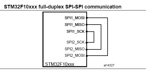

In addition I want to know why do we connect both MOSI together and MISO together too? in Full duplex mode?
why can't we use this wiring?
MISO->MOSI
MOSI->MISO
Thanks
Posted on January 10, 2017 at 07:34
MOSI means 'Master Out Slave In', i.e. on device configured as master it is output, on device configured as slave it is input.
Vice versa, MISO means 'Master In Slave Out', i.e. on device configured as slave it is output, on device configured as master it is input.
You always connect output to input.
PS. You seem to have forgotten to enable the SPI clock in RCC.
