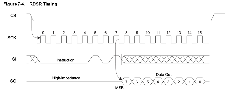

1. When I check the clock on the Oscilloscope - I don't get a square wave (it's something like a square wave with it's upper part curved), why is that happening? Is it OK to not to have a perfectly square wave?
2. What's wrong with the code below, I am trying to read the status register of the EEPROM. received_val remains 0 even after completely executing the code (I am debugging step by step)
3. However, when I start the code - it starts with a default value of 224 (does that mean that it read something during the previous execution of the code, I am asking this because I am making it 0 every time in code so how come it automatically becomes 224?) If it's correct why doesn't it reflect during the debugging?
PS - I have been stuck with this for almost about two months and I can't seem to figure out - I have tried all possible things to test SPI but none of them seem to work.
I'd really appreciate some help.

Well I don't know what SPI device you're using, and I don't have an SPI EEPROM/FLASH on my board.
You need to send a dummy byte to the device to get status back, when you shift the command out you get back bits at the same time, the device HASN'T received the command at this point, so you're almost certainly going to need to send at least one more byte to generate the clocks to get status back. What does the documentation show?
What is the bandwidth of the scope and probe you are using? What's the frequency of the clock signal? Use a 1X/10X probe, and switch it to 10X mode!

Posted on April 16, 2014 at 21:37
Where did you pluck 0xA5 from? Isn't the
http://forums.xilinx.com/xlnx/attachments/xlnx/ELINUX/3453/1/at25.c
command 0x05?
I'd send 0x05, 0x00
In these two months did you read the documentation?
Most 1X/10X scope probes in 1X mode have a bandwidth BELOW 8 MHz, so at 20 MHz the signal will look pretty awful.
Yes, the 20 MHz is the bit rate for the SPI bus

Posted on April 19, 2014 at 08:27
Yes, I know that read status command is 0x05 - I just made a mistake while posting it here and yes I did read the user manual as well as the data sheet of both the board as well as the memory.
1. I checked MISO with the Oscilloscope, it always stays low (The other pins are behaving properly).
2. I made a change - CPHA = 1, since according to the timing diagram the data is being sent at the trailing edge. (RDSR timing diagram).
3. I tried with sending a dummy byte. I still have no luck. (I sent both 00 as well as FF as the dummy byte)
4. I found another mistake - I wasn't making the HOLD and WP high (while copy-pasting I forgot to change the pin number)
5. The maximum APB2 frequency is 60MHz and APB2/4 will be 15 MHz, however the EEPROM requires 20MHz - will that be a problem?
Does the ''SPI1_send'' function seem fine to you?
Have I initialized SPI properly?

GPIOB->BSRRH |= GPIO_Pin_0; // set PB0 (CS) low
SPI1_send(0x05); //The read status opcode
GPIOB->BSRRL |= GPIO_Pin_0; // set PB0 (CS) high
received_val=SPI1_send(0xFF); //The dummy byte

Posted on April 19, 2014 at 10:58
I did not look at the whole thing, but am pretty sure that you do not need to deassert CS between the command and the data bytes in main:
// do not release CS
//GPIOB->BSRRL |= GPIO_Pin_0; // set PB0 (CS) high
//GPIOB->BSRRH |= GPIO_Pin_0; // set PB0 (CS) low
Posted on April 19, 2014 at 15:11
Yes, one of the salient details expressed in the timing diagram is the CS is low during the transaction.
20 MHz is the maximum speed, it can run significantly slower.
I've used code materially similar to read
http://www.winbond.com/NR/rdonlyres/7EB3B29C-1B35-421C-AA24-F430B51C776A/0/W25Q16BV.pdf
parts
Posted on April 20, 2014 at 06:53
Also you should probably observe that you don't need to RMW the BSRRL/H registers, you simply write the bits you want to set/reset.
I would focus on sending the READ ID or JEDEC ID type commands and getting back recognizable data.
