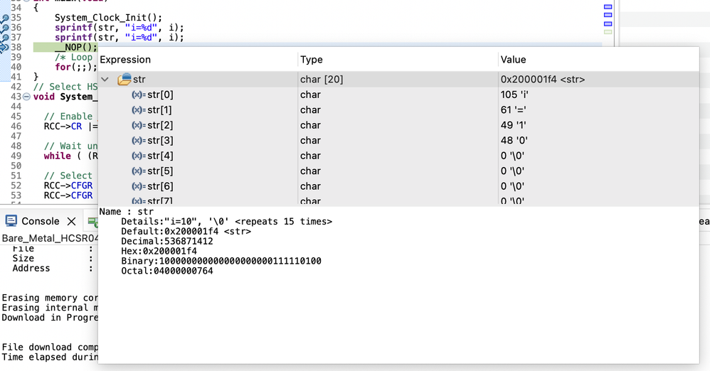

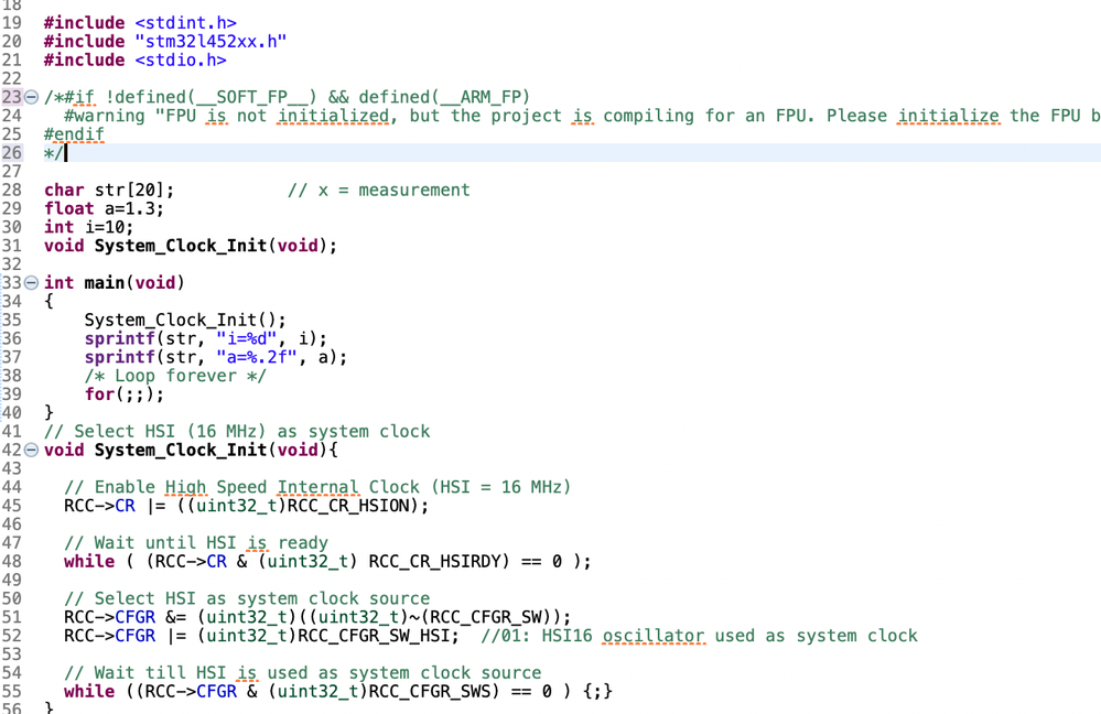

Although all settings are correct, sprintf doesn't work with floating point number only. Although it works on stm32cubeMX, it doesn't work on bare-metal program. It loops endlessly in the Default_Handler function. I'm about to go crazy.

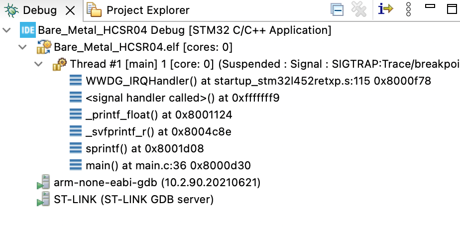

First sprintf properly works. But the second one does not. After second sprintf, I've traced back the code on the debugger and I can see that the DefaultHandler executes and traps the board in an Infinite_Loop as a result of WWDG_IRQHandler misfiring.
Error message tells me "No source available for "<signal handler called>() at 0xfffffff9" , No source available for "_printf_float() at 0x8001124", No source available for "_svfprintf_r() at 0x8004c8e", No source available for "sprintf() at 0x8001d08" . I can't seem to solve this problem, do you have any idea?
 Program is below:

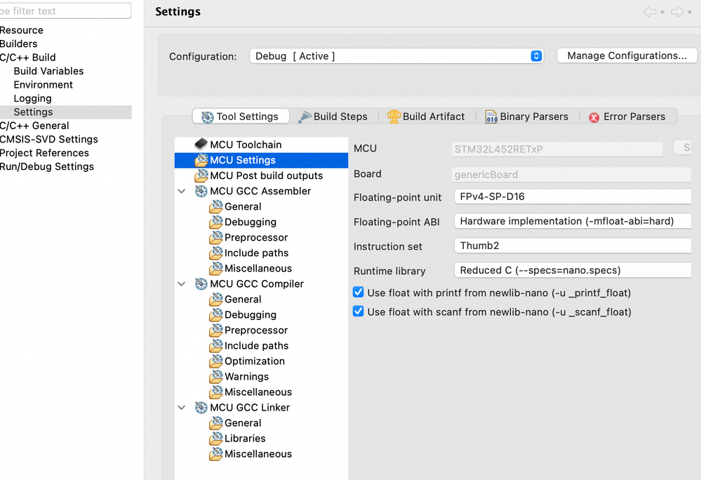

Here is linker flags.
 -mcpu=cortex-m4 -T"/Users/fatih/STM32CubeIDE/workspace_1.2.0/microprocessors/2023/Bare_Metal/Bare_Metal_HCSR04/STM32L452RETXP_FLASH.ld" --specs=nosys.specs -Wl,-Map="${BuildArtifactFileBaseName}.map" -Wl,--gc-sections -static --specs=nano.specs -mfpu=fpv4-sp-d16 -mfloat-abi=hard -mthumb -u _printf_float -Wl,--start-group -lc -lm -Wl,--end-group
Compiler Settings:
 -mcpu=cortex-m4 -std=gnu11 -DDEBUG -DSTM32L452RETxP -DSTM32L4 -DSTM32 -DSTM32L452xx -c -I../Inc -I"/Users/fatih/STM32CubeIDE/workspace_1.2.0/microprocessors/2023/Bare_Metal/Bare_Metal_HCSR04/Drivers/CMSIS/Core/Include" -I"/Users/fatih/STM32CubeIDE/workspace_1.2.0/microprocessors/2023/Bare_Metal/Bare_Metal_HCSR04/Drivers/CMSIS/Device/ST/STM32L4xx/Include" -O0 -ffunction-sections -fdata-sections -Wall -fstack-usage -fcyclomatic-complexity --specs=nano.specs -mfpu=fpv4-sp-d16 -mfloat-abi=hard -mthumb

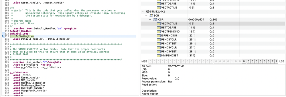

Maybe this has nothing to do with printf() as such, and it ends up in default signal handler because of unhandled interrupt?
What's the content of SCB->ICSR register at that moment?

Before:
_legacyfs_online_stmicro_images_0693W00000dJvzeQAC.pngAfter:
FEvra.1

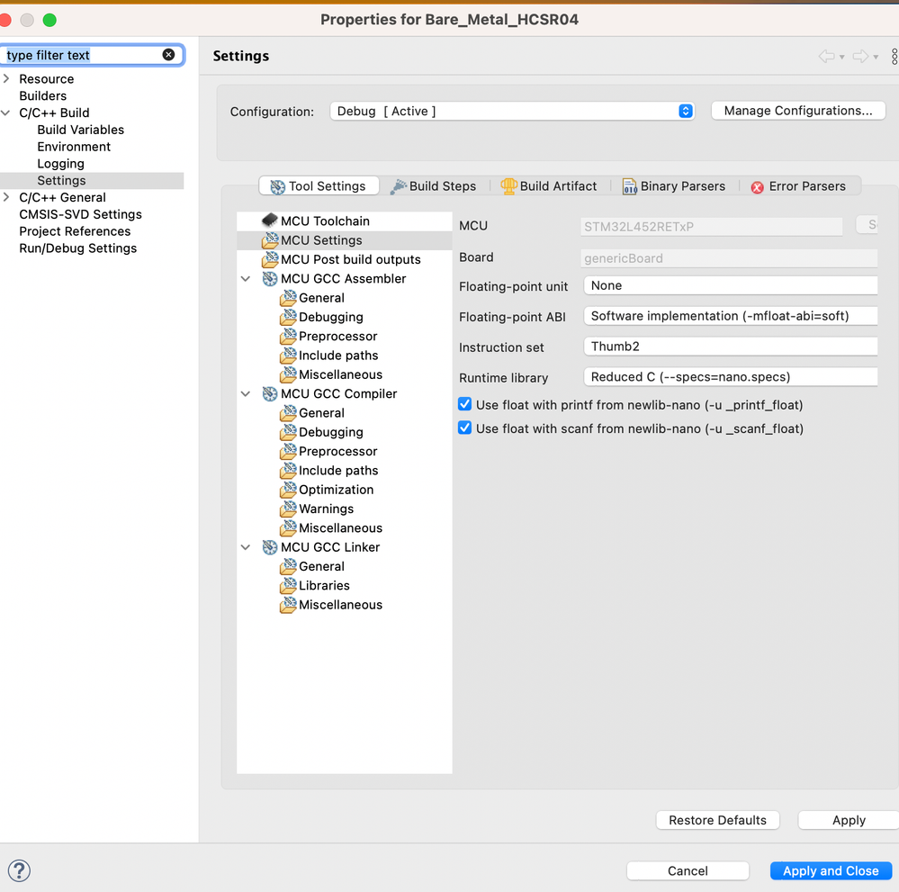

when I disable FPU, it works:)
waclawek.jan
Okay so VECTACTIVE is 3, which is HardFault.
