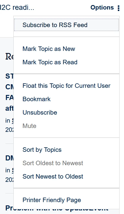

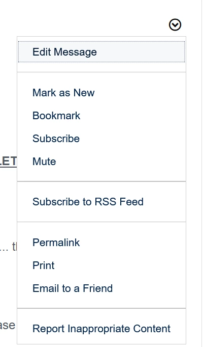

    there does not appear to be an option to delete the post (see screenshots below of the only two menus available at least on my browser)? Surely that cannot be...? How does someone delete a post?

    Right, because deleting content damages the forum. Explain what the issue was and how you solved it, as that might provide some value to visitors in the future.

    I appreciate what you are saying but I don't think deleting a post you made 10 minutes earlier would damage the forum.
    Most likely nobody even saw it and if you noticed it was a silly mistake you made and just found out soon after the post, I think it is more respectful to other members - especially those who try to help (like you) - to just delete it to avoid wasting their time. :)
    Perhaps allowing the poster to delete a post either until the first reply is posted or perhaps in the first 20 minutes or so might be a good idea (like Amazon allows you 20-30 minutes to delete an order and the card is not charged). Just a thought though... :)
