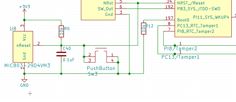

   I'm having an odd time with a board using the STM32F746VGT6 microcontroller that it requires that I reset the board each time that I power it up.  I have several of these and the phenomenon only occurs on about half of the boards.  When it does, it requires shorting the reset pin to ground as I don't have a reset button on this design.  I have checked solder joints of the 8MHz crystal and caps as well as the reset circuit (used from stm32f746 discovery board design).  The code is generated from CUBEMX.  It appears to run about 10 times as slow.  I'm trying to run the main PLL clock output at 192MHz.  Here is my startup code for the clock:

if you have to use a reset chip,
this one works well  2.94V threshold and 1.2S delay.

Posted on June 11, 2018 at 22:55
Thanks for the suggestion TJ.  I'll work it into the next design as a backup.  It can be unpopulated if I can figure this out otherwise.
