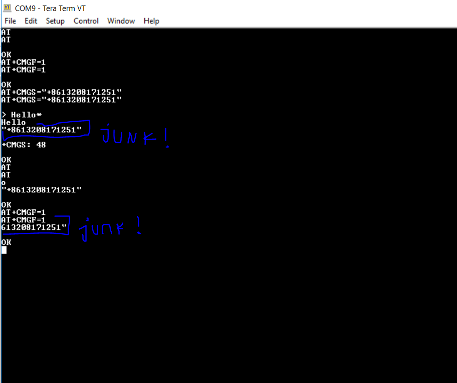

I'm trying to send message to sim900A via the serial port. The AT commands work but the GSM replies with some unwanted text (Previously sent text ) then finally OK. The GSM is supposed to reply what I typed with some prompts and finally OK. The picture below clearly tells what's happening. Is there any way to delete the data on the GSM buffer (If there is any) before sending a new one? 0690X00000989dUQAQ.png
CODE:
#include "stm32f10x.h"         // Device header
void clockConfig(void);
void UART1Init(void);
void USART2Init(void);
void GSMSend(void);
uint8_t recv[64];
uint64_t pos;
int main(void)
clockConfig();
UART1Init();
USART2Init();
while(1)
if (USART1->SR & USART_SR_RXNE)
uint8_t c;
do {
while((USART1->SR & USART_SR_RXNE) == 0);
c = USART1->DR;
if ( c == '*' )
recv[pos++] = 0x1A; // CTRL + Z
else
recv[pos++] = c;
// Echo back what you typed and save it in a buffer for later use
while((USART1->SR & USART_SR_TXE) == 0);
USART1->DR = c;
if ( c=='\r' )
recv[pos++] = '\n';
while(!(USART1->SR & USART_SR_TXE));
USART1->DR = '\n';
// Reset position for the next time
pos = 0;
} while(c != '\r');
    // Check is message has been completely stored in the recv buffer
    if ( c == '\r' ) GSMSend();
void GSMSend(void)
uint16_t buf = 0;
while(recv[buf] != '\0')
while(!(USART2->SR & USART_SR_TXE));
USART2->DR = recv[buf];
buf++;
void USART2_IRQHandler(void)
if ( USART2->SR & USART_SR_RXNE )
//uint8_t c = USART2->DR;
USART1->DR = USART2->DR;
