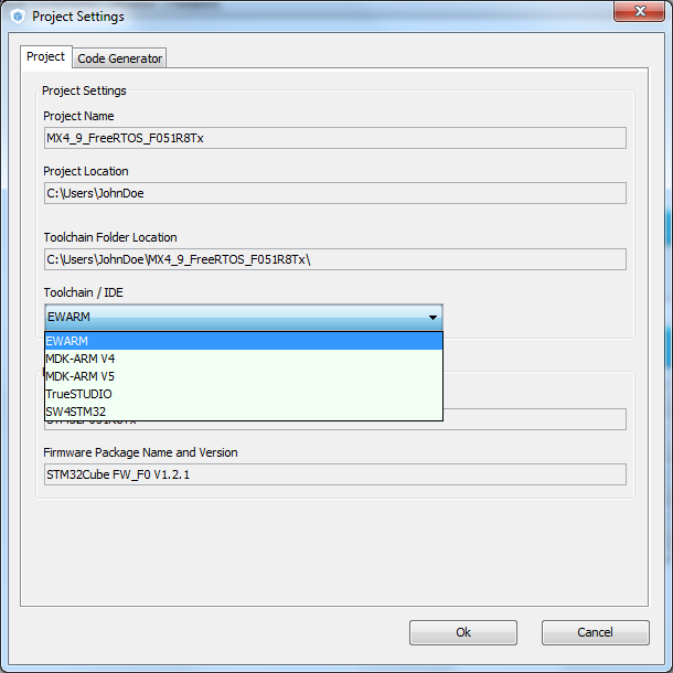

FCR
Posted on June 29, 2015 at 14:58
Hi Gerhard,
Altium Tasking is not a toolchain among the ''default'' ones supported in CubeMx GUI (cf screenshot).
Any way, it could have worked ''as is'' without the lines in FreeRTOSConfig.h (something to investigate on our side, maybe to improve, but for the moment, they are present!)
As a workaround, what you could try is to add  in the FreeRTOSConfig.h file, inside a user section, the following lines dedicated to Altium Tasking toolchain, something like:
#if defined(__ALTIUM_TASKING__)
    #include <stdint.h>
    extern uint32_t SystemCoreClock;
#endif
/* USER CODE END Includes */
Note: the code inside a ''user code'' section is not lost when re-generating code with Mx.
Then, definining that symbol (__ALTIUM_TASKING__) for your project in Altium toolchain (a setting dedicated to the C/C++ compiler, not to be defined for Asembler) could make things better for you.
