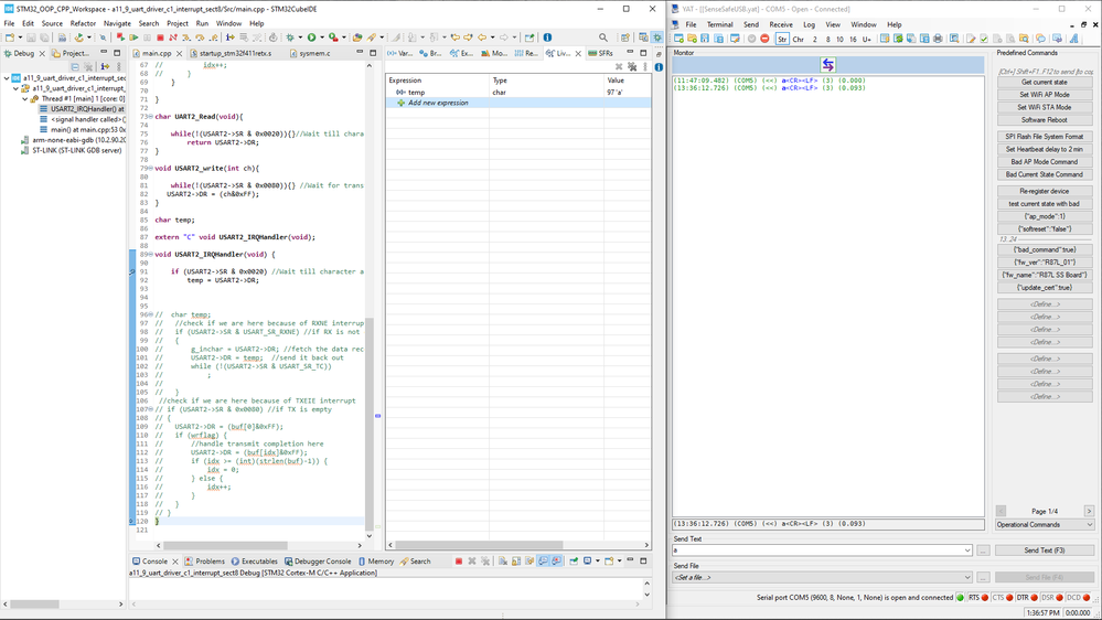

char temp; // global char variable.
// This does not work. It causes an error exception handle jumping to an infinite loop.
void USART2_IRQHandler(void) {
if (USART2->SR & 0x0020) //Wait till character arrives (blocking code)
temp = USART2->DR;

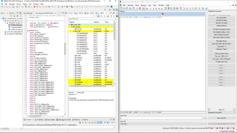

When it's in the infinite loop, pause and examine VECTACTIVE field to see which interrupt it's in. If it's USART2_IRQn, then the linker doesn't see your function correctly. C++ or C? Verify vector table entry for that IRQ points to your function and not the default handler.
MLi.6
Thank you for guiding me.
VECTACTIVE = 3 (Is it HardFault_Handler?).

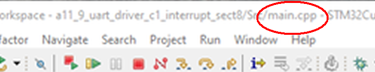

I am using C++, STM32CubeIDE
Version: 1.9.0
Build: 12015_20220302_0855 (UTC)
Guru
Yes, 3 indicates IRQn_Type of -13 which is a hard fault.
I don't think any of the code you've presented would cause a hard fault. But in any case, if it's repeatable, you can step through to see which line causes it. You can also examine the hard fault registers to find the offending instruction.
You can step through at the disassembly level to do individual instructions if necessary.
Looks like CSFR indicates a UNDEFINSTR flag.
If using C++, you need to ensure USART2_IRQHandler has C linkage by using extern C. Unlikely to be the issue here.

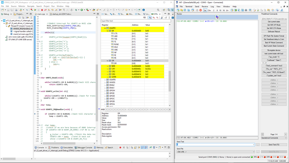

It jumps to 54 or 0x36 (USART2_IRQHandler).
184-130 = 54 or 0x36 USART2 IRQ Handler
VECTACTIVE = 0x36
0693W00000LvtUEQAZ.pngUSART2->RXNE flag = 1,USART2->DR= ‘a’

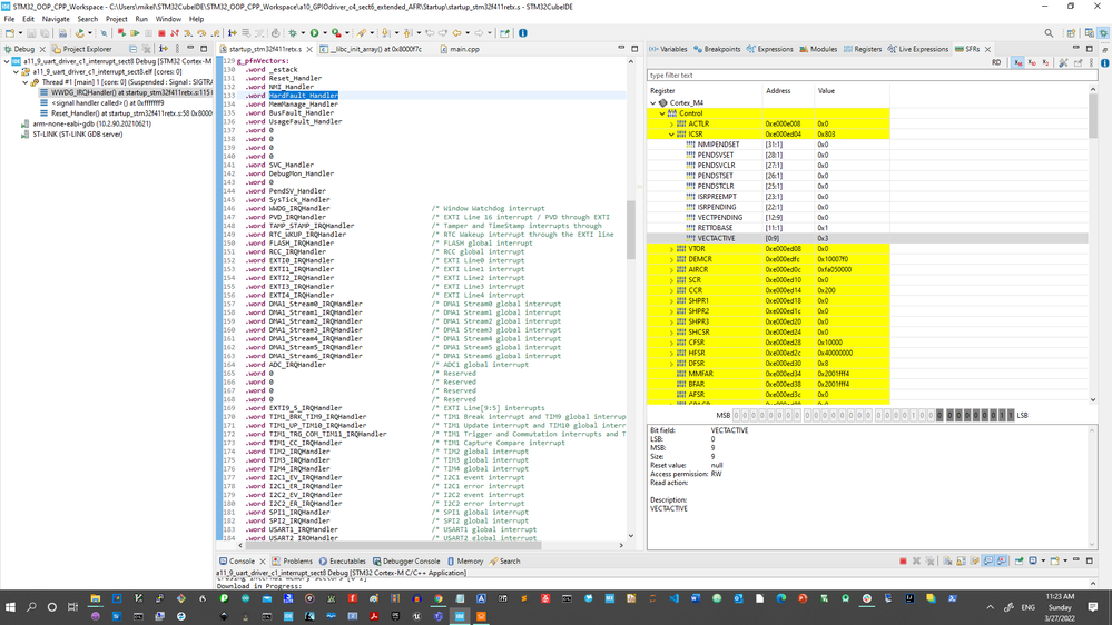

0693W00000LvtUxQAJ.pngAfter this, it jumps to the infinite loop. USART2->DR = 'a' (always). It looks that it can't jump to my ISR subroutine for some reason.
