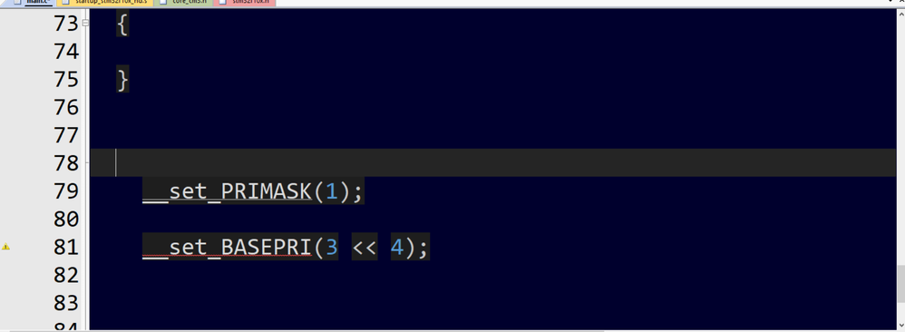

__set_BASEPRI -- implicit declaration
ASeyo
__set_PRIMASK(1); // No error
__set_BASEPRI(3 << 4); // Implicit declaration
This is a snippet of my code from keil uvision5. But, the IDE results in a syntax error; implicit declaration of function ' __set_BASEPRI ' is invalid in C99 is the error. Why can't the IDE detect __set_BASEPRI as a built in function?0690X00000D8iehQAB.png
3 REPLIES 3
Are those functions #included somewhere before they're used? Trace the include paths to ensure.
For me, they're declared in the same file, but maybe not on your implementation.
ASeyo
They are built in CMSIS functions and I have already included CMSIS Core. __set_PRIMASK works fine but __set_BASEPRI doesn't.
So it compiles fine? Maybe rebuild the index.
