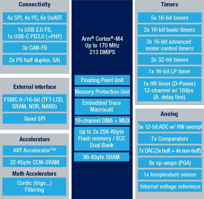

Dear brendi, I checked out all the variants of the STM32G474QE,CC,CB,RB,RE etc (all 12 of them) . All of them are showing only 14+12 = 26 PWM only, instead of 43.
Where as in the datasheet https://www.st.com/resource/en/datasheet/stm32g474qe.pdf it is 42. including the watch dogs.
So does that mean that this controller STM32G474QE can generate 42 independent PWM . I need only 36. Is this controller correct for me?
could you please advice. Thank you.
For the solution in the answer you have accepted as best, you can disregard the number of timer channels in the datasheet or elsewhere. It will work on any set of GPIO pins, you can take any STM32 controller that has enough pins.
