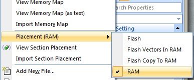

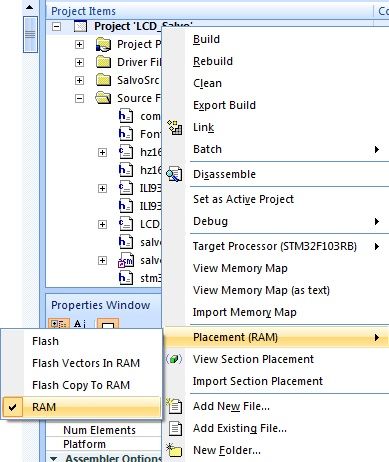

Posted on January 13, 2012 at 16:53
With Rowley Crossworks, it is as simple as making a selection from a drop-down menu.

Posted on January 15, 2012 at 11:42
teo.rene,
Where do you find this menu? I must be blind! :p
I'm using v2.1.2 on the Mac.
I did a little research into this and see the flash placement and ram placement xml files in packages/targets/STM32 directory. But, isn't Crossworks supposed to access this info automatically?
All I have in my projects' System Files folder is the STM32_Startup.s, STM32_Target.js, and thumb_crt0.s files. Are other files supposed to be in there?
I don't see my MCU part name (STM32F407xx from STMF4Discovery board) in the STM32_Target.js file.
Nevermind here, I see the part #.
I, too, would like control over where the code gets uploaded to.
On a related theme, I believe my code is going to flash (0x08000000), but after a reset, it will not run. How do I set the bootloader to run the code from flash after a power cycle/reset?

rmteo
Posted on January 15, 2012 at 16:12
Right click on the active project in the ''Project Items'' Window.
