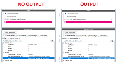

I've been able to get the higher frequency to output on the tamper pin but not the seconds pulse.
I tried updating the time registers in the main code but that didn't help.
There is a document I've glanced through but didn't see any code lines to implement (Clock/calendar implementation on the STM32F10xxx microcontroller RTC)
I have the RTC working on an L412 IC which integrates it with the LP Timer.
No use:
Config:
