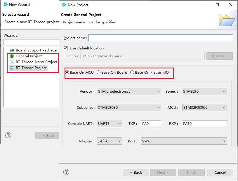

1-Support Different Project Creation Wizards:
Supports the bare board project creation, RT-Thread-based project creation, and many other creation wizards, developers can create projects based on ST series MCU or the development board:

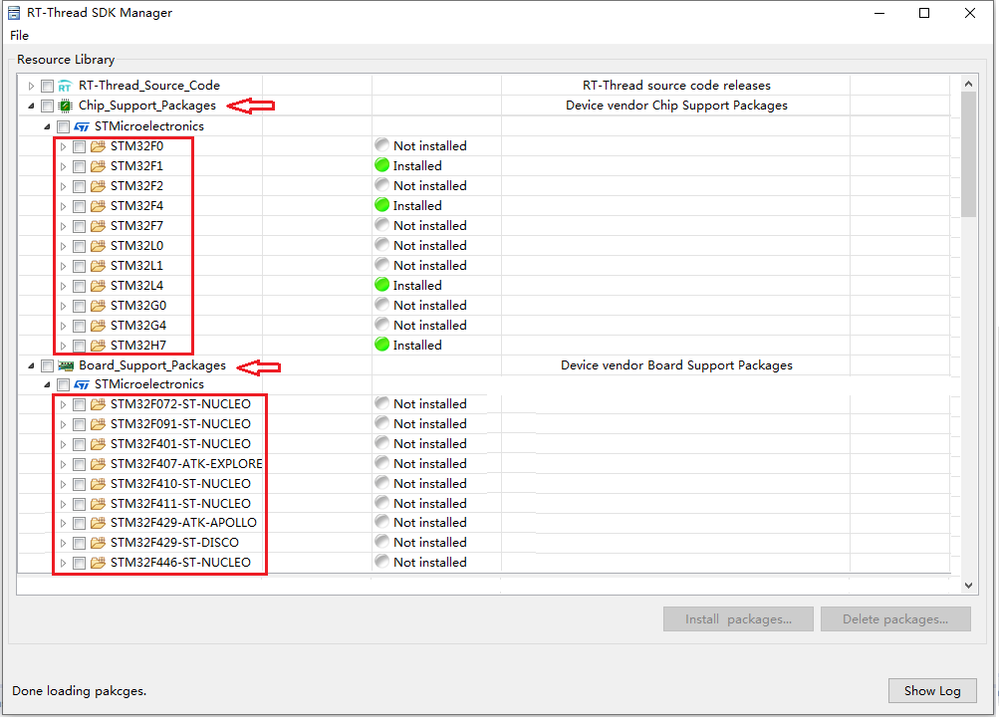

2-SDK Manager Supports ST All Series of MCUs and 40+ Dev Boards:

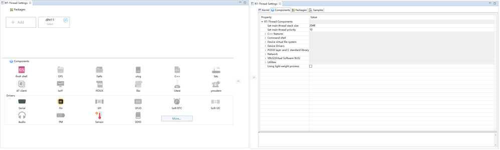

3-System Configuration Feature
RT-Thread configuration features include both framework configuration and tree configuration, where packages can be added through the Package Center and related components can be enabled directly by clicking on the component icon. Under the tree configuration interface, all configuration options can be configured directly. In addition, the configuration tree right-click menu has added a search function to facilitate the location of the target configuration items.

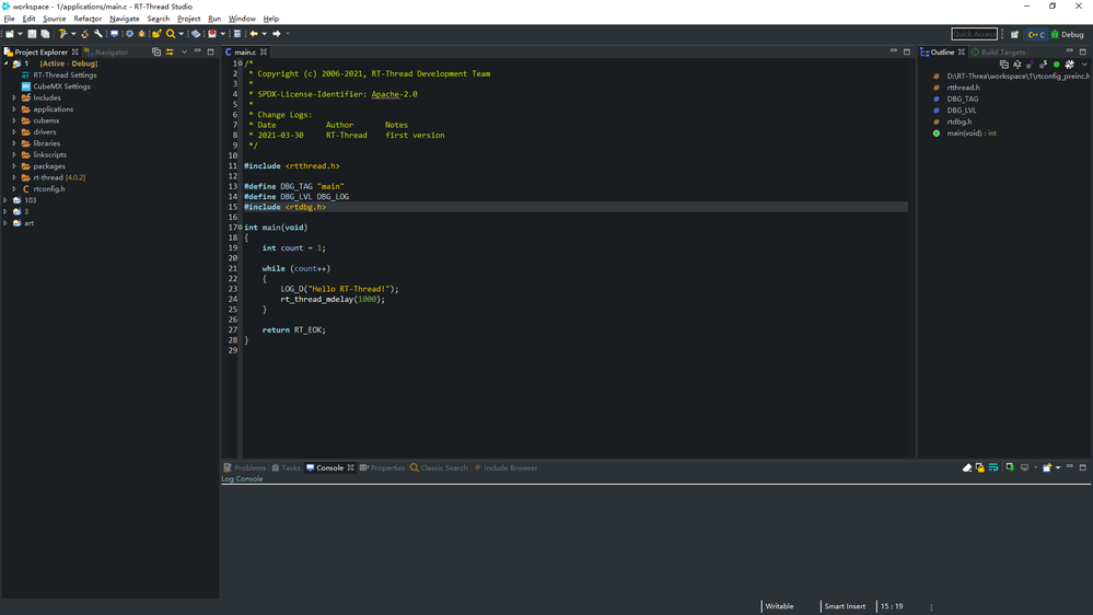

4-Easy-to-use Toolbar Buttons:

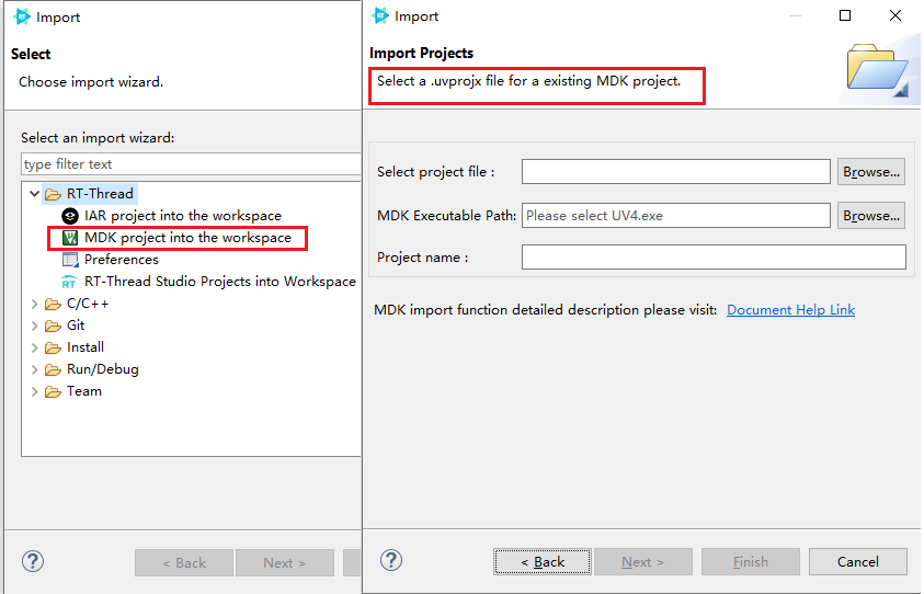

5-Support MDK Development
RT-Thread Studio v2.1.0 supports bilateral synchronous co-development with the MDK project. You can import an existing RT-Thread MDK project directly into RT-Thread Studio, and the configuration of the MDK will be automatically synchronized with the RT-Thread Studio project. RT-Thread Studio provides a bilateral synchronization mechanism that allows the project to switch between MDK and RT-Thread Studio at any time. The MDK configuration feature is also supported to perform configuration items such as C/C++, ASM, Linker and automatically synchronized with MDK projects when the configuration is completed. If you modify some configurations on the MDK, you can manually trigger synchronization at RT-Thread Studio to sync the modified configurations with RT-Thread studio projects.
For more details please check out here!

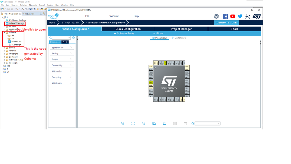

6-Support CubeMX Development
RT-Thread Studio v2.1.0 is also in collaboration with STM32CubeMX, where you can open CubeMX Settings directly in RT-Thread Studio. After configuration, click the button GENERATE CODE, and the code generated in CubeMX will automatically be copied into the RT-Thread Studio project directory, no further modifications are required. Then it is automatically added to the compilation. We only need to compile, download and debug programs as usual.

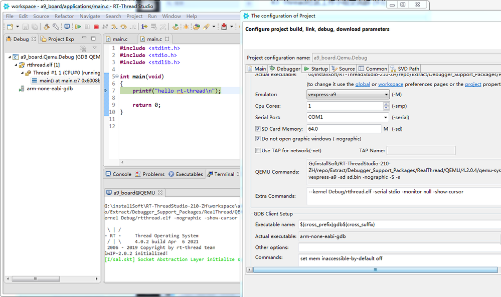

7-Support QEMU:
QEMU is a cross-platform simulator that supports many development boards. It is convenient to validate prototype development if you don’t have a development board and hardware debugger on hand. RT-Thread Studio provides direct support to QEMU simulation debugging which has the following features:
  • Create a project that uses the QEMU simulator by default
  • Visual configuration of QEMU command parameters
  • Simulate physical boards for breakpoint debugging
  • Supported dev boards:
  • STM32F407-ATK-EXPLORER
  • STM32F429-ATK-APOLLO
  • STM32F429-FIRE-CHALLENGER
  • STM32F429-ST-DISCO
  • STM32F401-ST-NUCLEO
  • QEMU-VEXPRESS-A9
  • STM32F410-ST-NUCLEO
  • GD32VF103-NUCLEI-RVSTAR

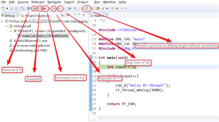

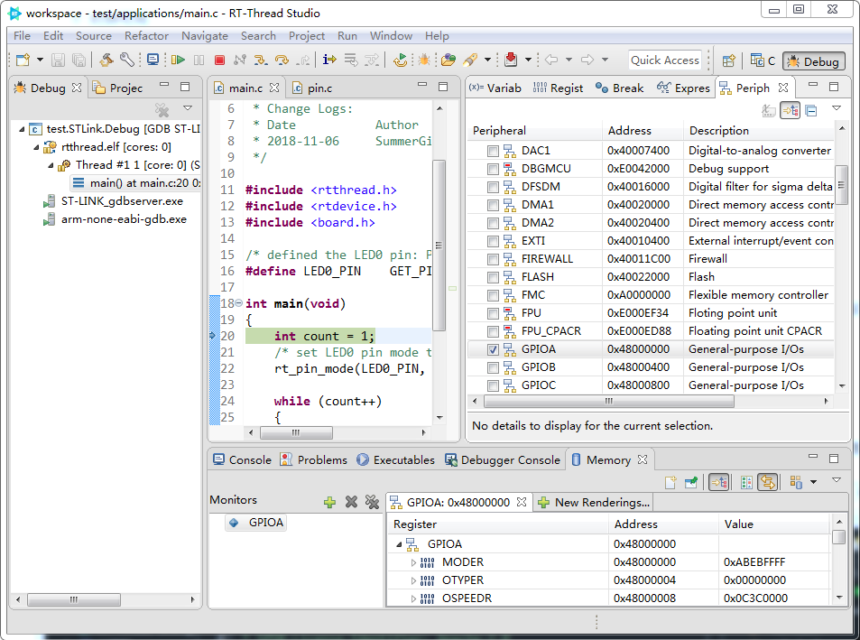

8-A Variety of Debuggers Are Supported
Supports commonly used hardware debuggers like JLINK, STLINK and CMSIS-DAP LINK, and supports a wide range of many other debugging functions. For example, terminal function, users can easily check out the chip core registers, peripheral registers, variables, expressions, assembly code and memory data, supports assemble instruction step mode, breakpoint management and so on!
