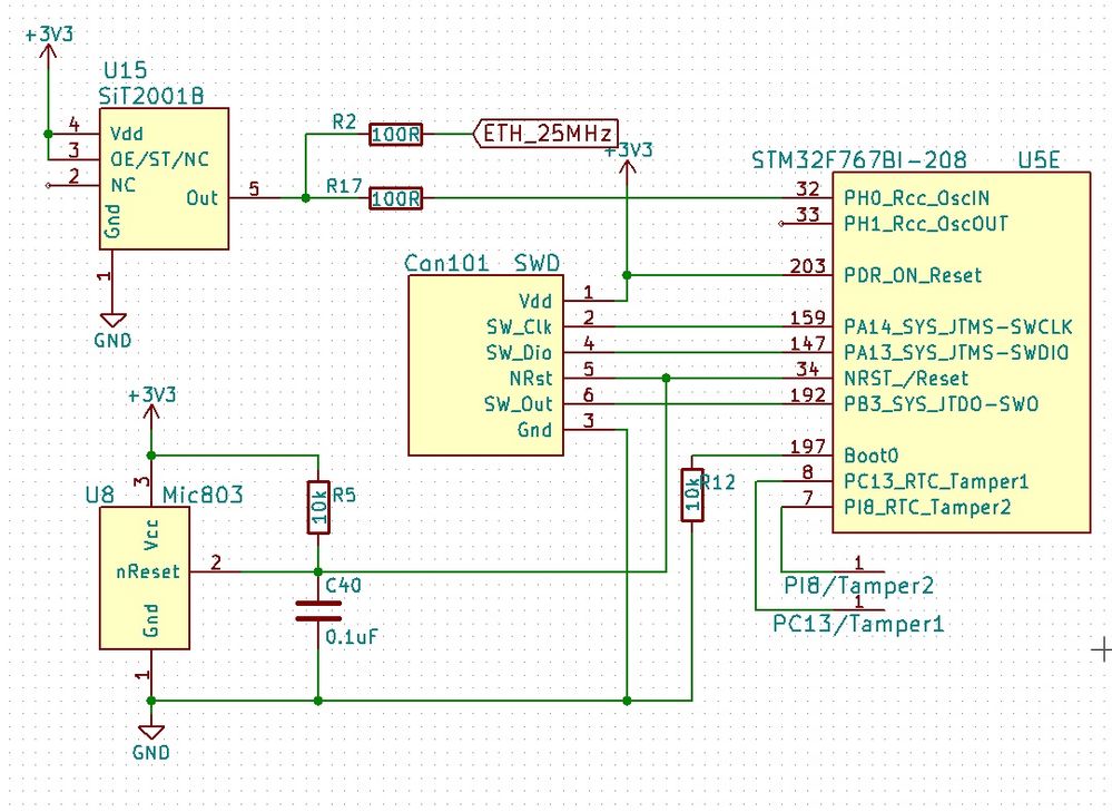

Hello, I'm using stm32f407vgt6 MCU in a control system and I'm facing a strange problem in the reset circuit, when I power on the system it doesn't start until I put a short circuit wire manually between reset pin and GND and then remove this wire so system can start properly. system's external reset circuit consists of pulldown 0.1uF capacitor and pullup 10KOhm resistor. I have tried to replace the 10KOhm resistor with 100KOhm but nothing changed. I also replaced the 0.1uF capacitor with 1uF and also nothing changed. Could someone help me to find out what may cause this problem and why I need to connect the reset pin to ground for just a second in order for the system to start?

' when I connect the NRST to GND it start and continue without any problems?'
that should cause the problem.
' unexpected reset and program counter corruption can be
reproduced by manually forcing a low state on the NRST pin or the Oscillator pins for 1 second.' ref:page 110/201 DocID022152 Rev 6what does the PCB do with the Oscillator pins ?
what is the primary power supply ? 12V, switched down to 3v3 ? or a 5V charger ?
‎2017-07-08 8:28 AM
I don't know.
Holding the NRST low for several hundred ms doesn't help, but you can down load code and run in debugger.
You need to look at pins and clocks the debugger enables that you might not be. Look at DBGMCU settings. Look at HSE and PLL code. Look at behaviour that could be impacted by component tolerances/differences.
You REALLY need to get serial output (not via VCP) so you can diagnose code flow and status WITHOUT attaching the debugger. Instrument the code and have a Hard Fault handler that outputs useful data.
You want to be looking for timing critical loops, or other things where the debugger may have changed timing or responsiveness of the system.
You need to move beyond focusing on the one-second NRST, and start examining what's actually happening.
