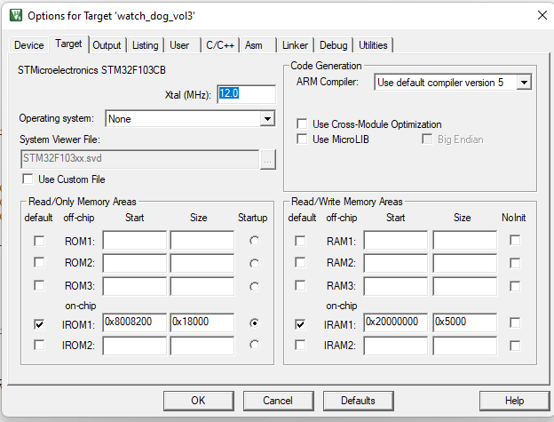

I'm working on stm32f103 and I found one problem which has a weird solution.
In my project, I have a bootloader and main source. I use the 0x800000 address to start the bootloader and 0x8008200 to begin my main project (the bootloader jumps to this address). after changing the main project:
address I defined also:
#define USER_VECT_TAB_ADDRESS
in "system_stm32f1xx.c"
it opened me section where I wrote this

after this everything works great if I will add __eneable_irq(); in the main source

so why is it needed and why it doesn't work without enabling? is there some bug in shifting the IRQ vector? if I won't write this, project will be broken at the first IRQ

Look at the bootloader you use. I guess it disables interrupts before jumping to the application. 0x8008200 is strange choice - it's in the middle of Flash page; why not 0x8008000?
Also, it's better to set the VECTBASE in the bootloader and remove any VECTBASE setting from the app. This way the only thing to change in the app while relocating the app is the Flash base address.

this is not an ST-specific part, the SCB->VTOR is part of the Cortex-M core and the vector relocation is described in ARM documentation. You'd have to ask ARM why they decided to have global IRQ disabled by default after writing the VT offset.

ARM doesn't disable the interrupt, and code doesn't expect it to be disabled.
SOMEONE disabled interrupts in their bootloader. Code provided, and code endlessly duplicated, propagating flaws and expectations.
A better solution is to set SCB->VTOR with a symbol for the vector table that the LINKER can fix up. Why it is a define is beyond me, as it requires a lot of changes with what could be automatic and based on the settings in the Linker via the Scatter File or Linker Script. It takes an address, this Base/Offset is just some confusing concept someone inserted here.
yes, it was my fold. i disabled everything before jumping. thanks
