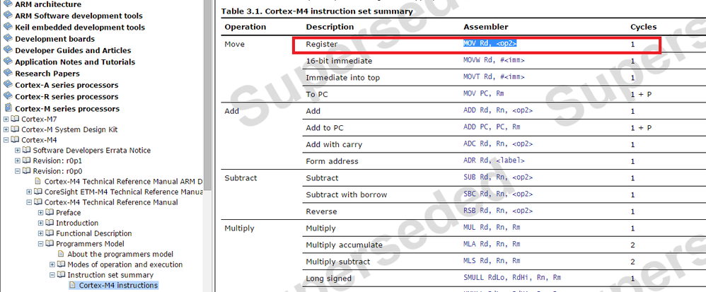

Let’s start with this example :
Let’s suppose I work with an STM32F407VGT6 microcontrollers which his System core clock is set at his maximum frequency which is 168MHZ.
According to the ARM website the CORTEX-M4 assembly instruction
MOV Rd, <op2>
takes one cycle to be executed. That’s mean this instruction is executed in 5.95ns??? is that correct ??
here’s how I did :
168MHZ = 168 000 000 pulses / secondeSo 1 pulses takes 1/168 000 000 = 5.95ns to be executed
thx.- Mark as New
2015-05-04 4:34 PM
Basically that's how it works, things get a little murkier with slower buses, write buffers, FLASH memory and caches, etc.
