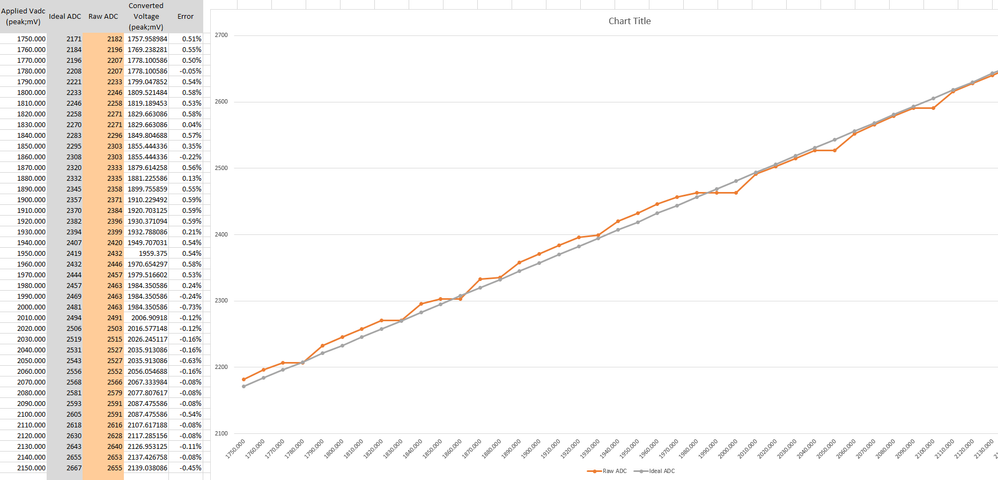

Dear all.
I measured ACD input increasing the voltage by 10mVdc. but, there are non-nonlinear points.

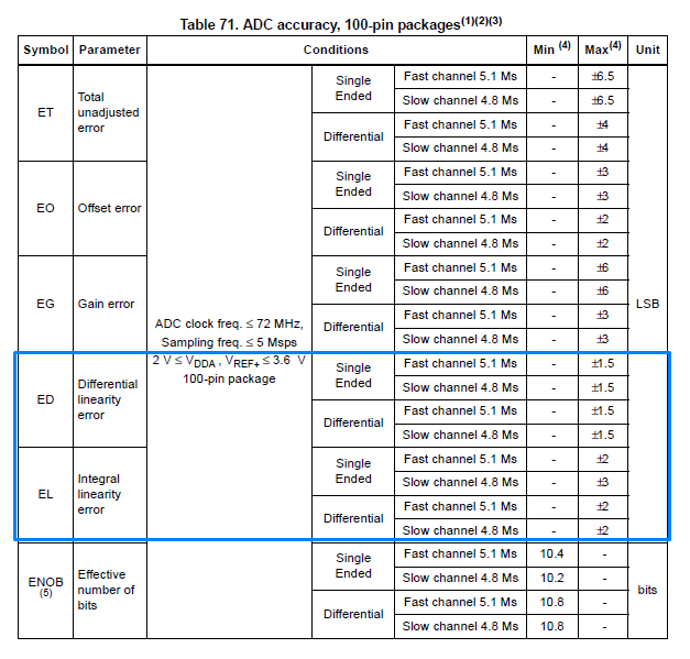

As the datasheet, ED and EL are +-1.5LSB and +_2LSB. It seems that my measurement result is bigger than them.
Could you please explain how to reduce the error?
Thank you in advance.
Vref : 3.3V
ADC clock : 72Mhz / 2 = 36Mhz
1 LSB : 3.3V / 4096 = 0.805664063
ADC channel : Fast channel ADC1 3channel
Sampling mode : Single-ended
Sampling time : ADC_SampleTime_7Cycles5

Have you checked that your test conditions (electrical and software settings like sample time) match those stated in the datasheet you cited ?
Posted on November 28, 2017 at 01:26
I think below my condition was satisfied with those test condition on the table.
  1. ADC clock freq : 36Mhz <= 72Mhz
  2. Sampling freq : 2.57Msps <= 5Msps
    • ADC clock = 36Mhz
    • Tconv = 7.5+12.5 = 20 ADC clock cycles
    • Sampling freq. = 20 / 36*10^6 = 555.55ns; 1.8Msps
  3. Vdda = Vref+ = 3.3V
