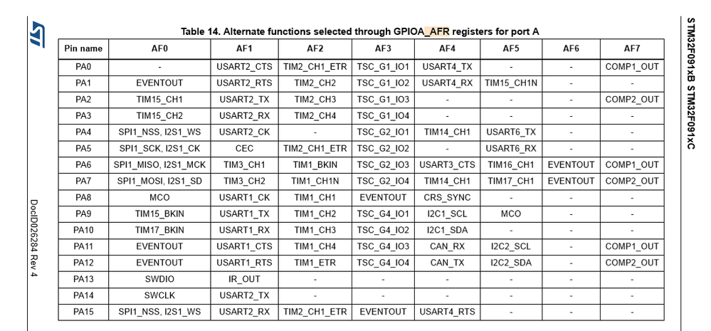

Hi, is it possible to connect STM32 instead of display and read its pins (A0, RD, WR, D0, D1, D2, D3, D4, D5, D6, D7) to know what device is sending and maybe replace original display with different display?
For example I would need to detect that WR pin went LOW and read all pins values at that moment in time. WR is LOW only for 187 nanoseconds. So is there any way to read this fast with STM32? How does display read that data so fast?

Code:

I did read the reference manual or at least tried to, but its not really understandable easily. Also I find many PDFs and not even sure if I am looking at correct table.
Is it correct table and I need AF2?
You mentioned TIM2_CH1, but all I can find is TIM2_CH1_ETR?
As I understand from reading you post more times the problem is in this line:
GPIOA->AFR[0] = (GPIOA->AFR[0] & ~GPIO_AFRL_AFSEL0) | (1u << GPIO_AFRL_AFSEL0_Pos);
//Note that AFRL corresponds to AFR[0], and AFRH to AFR[1].
So I tried to think how to fix it:
Select AF2 on PA0 in AFRL for TIM2_CH1_ETR
AF2=0x02
PA0=GPIO_AFRL_AFRL0_Pos
AFRL=AFR[0] (because if want to use 0-7 PINS)?
AFRH=AFR[1] (because if want to use 8-15 PINS)?
GPIOA->AFR[0] |= 0x02 << GPIO_AFRL_AFRL0_Pos;
Is it correct?
Any help?

Setting the AFR looks like right, as long as bits 0-3 are 0 before. It is 0 after reset, so it would work for now. But keep in mind that some peripheral registers might have reset values different from 0, always check the register description in the reference manual.
Set and check the GPIO MODER bits. Check the reference manual again, note the reset state, all bits are 0 which means the pins are set to input, you don't have to change them except for PA0, which has to be set to alternate function mode. So figure out what should go into GPIOA->MODER, and be careful not to change the bits at higher positions corresponding to PA13 and PA14, because that's your debugger connection.
Now you can start with the timer. You will need it in input capture mode, so implement the procedure in the TIM2 functional description / Input capture mode chapter. Leave the input filter bits alone (0), you don't want to filter out a short pulse on WR completely, do you? Start the timer at the end by setting TIM_CR1_CEN, and observe TIM2->CCR1 changing each time there is a pulse on PA0. Try changing the code to detect falling edges instead of rising ones.
... to be continued when the above is working
Indeed something is with this forum, because I was not able to see your previous replies for some time... Any way I have edited and added my code to first post.
As for the GPIOA->MODER, I have observed that its initial value is 0x28000400 (not sure why there is "4" in it) and after that this:
GPIOA->MODER = (GPIOA->MODER & ~GPIO_MODER_MODER0) | GPIO_MODER_MODER0_1;
it becomes 0x28000402 which is not correct? it should not be 0x28000401 as "1" would represent that its zero pin "PA0"?
GPIOA->AFR[0] becomes 0x00000002
