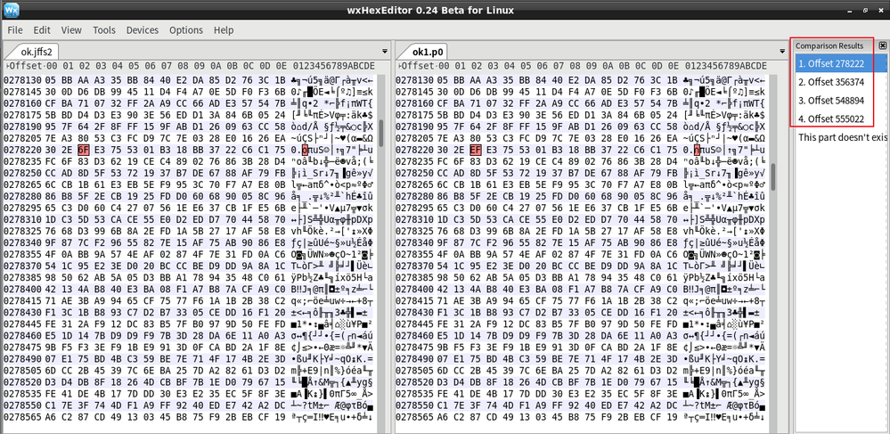

I port uclinux to my board with stm32f767igt.I want to boot uclinux from nand ,so i add nand flash support with mtd framework.when i test my code, i use dd command to read data from /dev/mtd*,like
dd if=/dev/mtd0 of=ok1.p0 count=2048
because my first mtd part from 0x0 to 0x100000,i burned my rootfs file named ok.jffs2 to this part.
when i diff ok1.p0 with ok.jffs2,I get some data error,
then i try dd again as below
dd if=/dev/mtd0 of=ok.p0 count=2048
I diff ok.p0 with ok1.p0,
as we can see, these files are different too,so i wonder is the drivers problem or nand flashs attrabutes?
