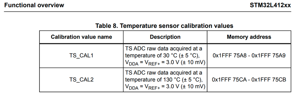

Im attempting to migrate code from a STML0 to L4 and I am getting very different values from the calibration values on the L0 the Values are 666 and 911 and I am getting consistat temperature reading that are within a couple of degrees of the ambient temperature. On the STM32L412 if a read the values using int16_t TEMP130_CAL=*TEMPSENSOR_CAL2_ADDR; and int16_t TEMP30_CAL=*TEMPSENSOR_CAL1_ADDR; I get 1381 1037 and the ADC values are similar to the L0 either using ( myTemp -TEMP30_CAL)*(130 - 30)/(TEMP130_CAL - TEMP30_CAL)+30 or __LL_ADC_CALC_TEMPERATURE(3300, myTemp , LL_ADC_RESOLUTION_12B); consistantly returns a temperature of -60 to-80 degrees

Are you reading from the right location?

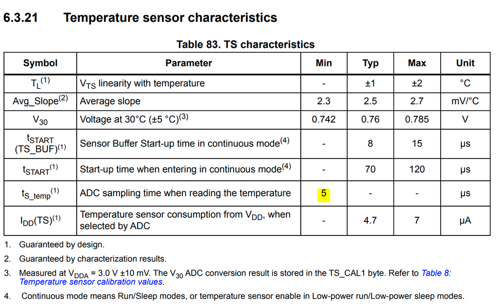

Is your sampling time at least 5us per the datasheet?
