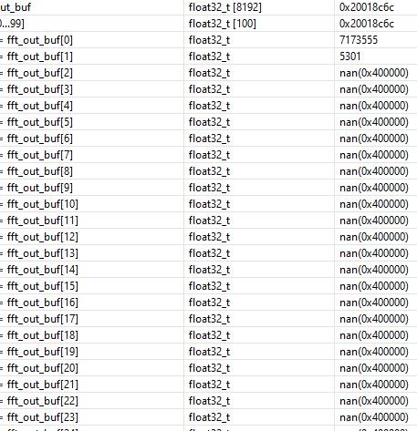

When I'm looking at the contents of the sample, I'm getting sample[0] and sample[1] filled with information (that doesn't match my octave data) and the rest are nan.
Is it safe to assume the nan is because it's a complex number and can't be displayed?

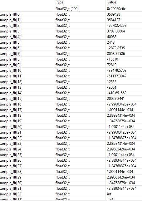

Some additional context about what is weird, I expected to get the real portions stored in sample_flt and the imaginary portions stored in fft_out_buf, which I believe how this code works (or at least how it appeared to work in other code).
What was odd about this is that I received 16 "normal sized" real samples in sample_flt (without exponents), 16 additional real samples (with exponents in the xxxxe+034 range), and then the rest seemed to vary between the inf, -inf, and nan.
For the imaginary portion, I received two "normal sized" imaginary samples and the rest were all nan.
I expected I might have some differences between octave and this that I might need to resolve/understand, but it seems odd to have such massive differences, which makes me think I am doing something wrong. What's odd is this doesn't seem to be a particularly complicated function so I'm not entirely sure what the core of the issue is.

Here's the real portion (sample_flt):

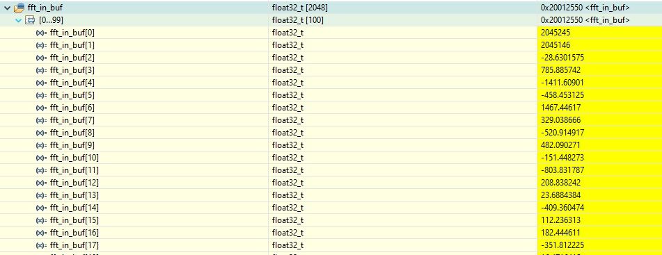

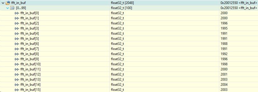

I then put in a 2.2khz tone into the mic (which I can only assume is the same frequency modems used back in the day by my ears) and ran through the code. It appears to be working as expected, even with my changes (it had an external GUI for doing a spectrum analysis and it analyzed the core frequency spike correctly, which is good).
This is the data before running the FFT:0693W00000DmZMZQA3.jpg

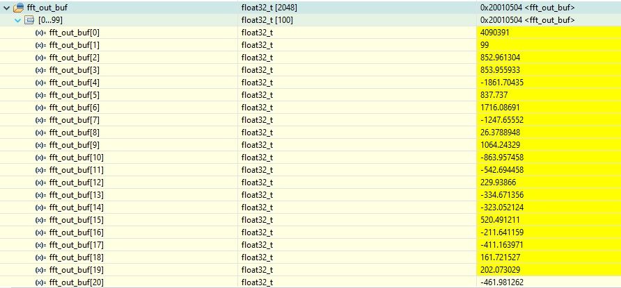

Here is the data post FFT:0693W00000DmZJlQAN.jpg0693W00000DmZQ2QAN.jpgSo my understanding (based on the above example) is the out of the FFT function (fft_out_buf) was the imaginary portion without the i argument, would I be wrong about this? If that is the case, I'm a bit confused as to why I'm getting the results I'm getting. If my understanding is wrong though, that could be an explanation. I tried converting the values in my project using that same complexABS function but the output of my project just gave a bunch more nans.
I guess what I'm still confused about why I'm getting the results I am on mine. I don't fully understand what the problem is. I can simulate the results in octave and it doesn't match there and the data doesn't even really make sense.
Is there a chance I have an issue like I'm out of RAM (even though my resource manager shows I have plenty) or something more along those lines than with the data itself? My resource manager shows I'm sitting at about 31% of each (so, unless that's wrong, I should be ok. Not sure if I'm getting a spike of RAM usage that might not be tracked there though).
Ok, I might have found the issue. I went back to the tone example above, had it working with an FFT size of 2048. Tried it at 4096 and it worked fine. Tried it at 8192 and got similar issues. I assume it's a RAM limitation and I'll likely need to move to a chip with more RAM than this one.
