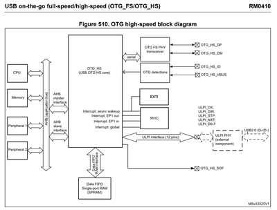

I need to do some testing with the STM32F767BIT6 MCU, to use the USB 2.0 HS USB peripheral. I can see it's used on this dev board ( https://uk.farnell.com/stmicroelectronics/nucleo-f767zi/dev-board-nucleo-32-mcu/dp/2546569 ) but the data sheet states that "USB OTG full speed or SNK/UFP (full-speed or high-speed mode), depending
on the USB connector type". Does this mean there are variants of the dev board itself, or that it depends on which host device this board is connected to? I cannot work with USB 2.0 FS, as it's too slow for the application.

STM32F767 MCU has two USB 2.0 device/host/OTG controllers as stated in the reference manual. The first is a full-speed controller with an on-chip FS PHY. The second is a full-speed/high-speed (FS/HS) controller that integrates the transceivers for FS operation and features an ULPI for HS operation.
However, to use the HS operation, an external HS PHY connected to the ULPI is required. This means that the speed (FS or HS) depends on the configuration of the MCU and not on the host device.
One more thing, STM32F767BIT6 chip has not the same package as in Nucleo-F767ZI.

Hello @Smashcat
The diagram is extracted from RM0410 to specify the controller's features and specifications.
For the implementation, you refer to user manual of boards as you mentioned.
