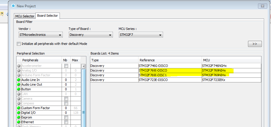

Hello Team,
I have purchased STM32F7 disco board. I want to use CubeMx tool to generate code and modify/use it.
Can I get CubeMx project for STM32F7 discovery board : STM32F769i - DISCO (MB1225B)
Thank you,

Balaraju Arror
Posted on June 30, 2017 at 15:33
Hello Nesrine,
Thank you for the help. I will use this example to explore QSPI.
I have other question is, can I get CubeMx project for the discovery board: STM32F769i - DISCO (MB1225B).
I want know how the components are configured in STM32CubeMx project. This I will take reference for my development.
Thank you,
Posted on June 30, 2017 at 15:40
Posted on June 30, 2017 at 15:51
Hello Nesrine,
I am sorry, I could not explain correctly.
I have some knowledge on STM32MxCube. I know how to configure components.
But in case of Discovery board I do not have schematic. If I can get cube project, I can understand which all are components are connected to the host and via which communication they are connected. How LCD is connected? Of course via DSI, that I understood. But how LTDC is controlling ?? Which buffer is used for screen composition ? external SDRAM? how this SDRAM is accessed? via FMS?? DMA?? , why QSPI is used? to execute the code or only to fetch fonts etc.
If I can get the cube project that would be great help
Thank you,
Posted on July 04, 2017 at 10:36
Thank you,
I got answer in previous reply. I could not realize it.
Posted on October 19, 2017 at 10:18
