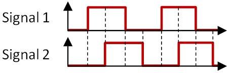

hi all,
please i need help. I have to generate 2 signals PWM like this:
I think that we should insert a dead time. How to do it plz?

    Posted on March 22, 2013 at 00:14
    Set up two timers, with 50/50 duty, and frequency you want. Program the 90 degree phase difference via the CNT register of one timer with respect to the other.

    Posted on March 22, 2013 at 12:50
    Hi Clive, please can you help me ? what is the value of this register (cnt)
    Tesla DeLorean
    Guru
    March 22, 2013
    Posted on March 22, 2013 at 14:25
    If
      TIM_TimeBaseStructure.TIM_Period = 300 - 1;
    For Duty
      TIM_OCInitStructure.TIM_Pulse = 300 / 2; // 50% for duty
    For Phase
    Delta in CNT for one timer vs other will be 75, ie 300 / 4  for 25% or 90 degree phase shift
