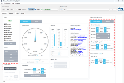

I am using STM32 Motor Control SDK / MC Workbench with sensorless FOC (STO + PLL) to drive a low-speed, high-inertia 24V 40W BLDC fan motor.
Power Board: X-NUCLEO-IHM07M1
Issues observed:
  • Motor rotates stably but produces intermittent (not continuous) rubbing noise, mainly after settling at certain RPM.
  • Large speed oscillations are visible in Motor Pilot (speed dial deviation).
  • Motor does not reach max speed even when increasing current limit in MC Workbench.
  • Reducing Iq PI gains(cut off frequency) does not significantly reduce the noise.
  • Very low PLL gains are required for stable rotation; higher PLL gains cause oscillation or loss of speed feedback.
pilot_register_observationpilot_register_observation

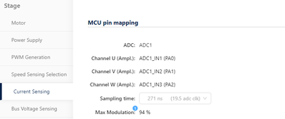

Hello @Mani2,
Rated max speed could be limited by the Maximum Modulation Index available in
Reduce the PWM frequency to obtain an MMI value as close as possible to 100%.
If you agree with the answer, please accept it by clicking on 'Best answer'.Best regards.GMA

GMA
January 26, 2026
Hello @Mani2 and @Prof_McGonagall,
With the Motor Pilot Advanced Configuration, tune the speed PI regulator parameters to optimize RPM stability. Tune the torque/flux PI regulator parameters to optimize torque response.
