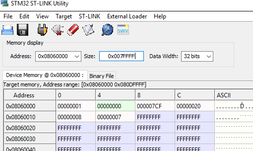

I successfully write to FLASH but when I try to read I get 0.
First I read some data from keyboard to initialize "inter" variable.
Then I store it in FLASH, but I can't read it.

Data are stored in FLASH and I can check it in STM32 ST-LINK Utility:0690X000006CrQeQAK.png

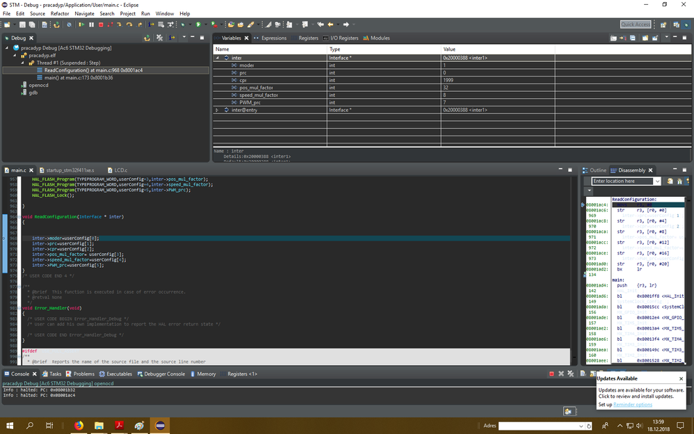

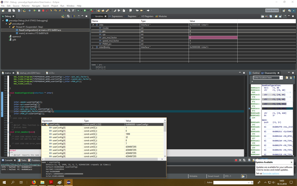

Hera are some screens from debug perspective:
This is after reading from keyboard and writing to FLASH:
Data in userConfig[] are correct but it writes 0 to "inter" variable

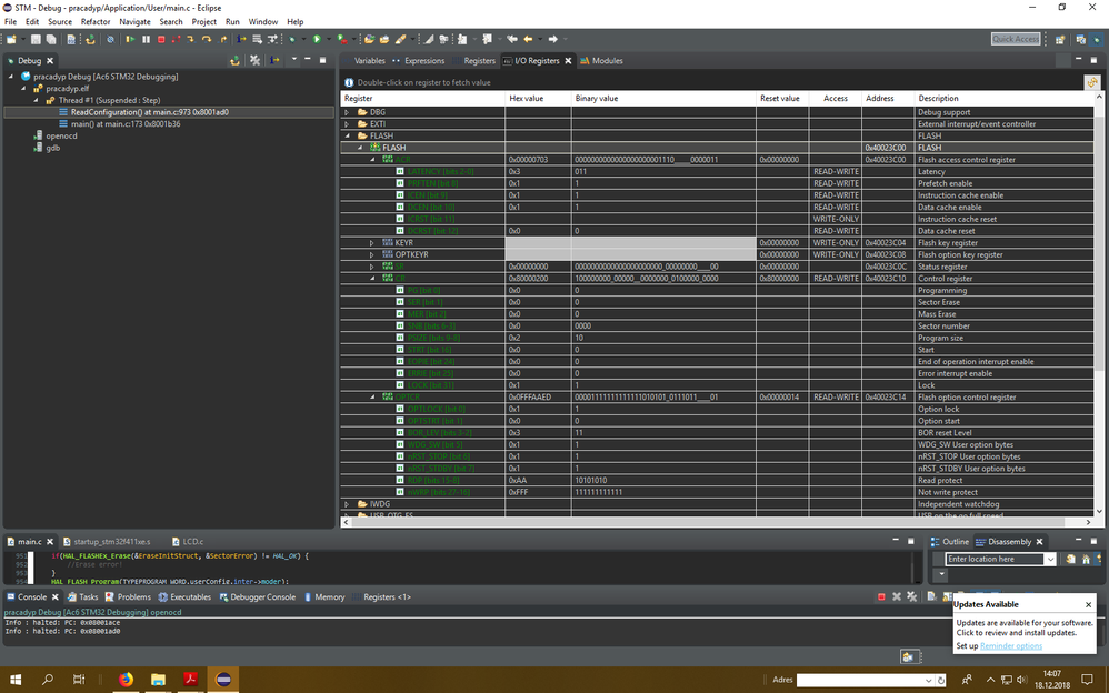

And here are FLASH registers:
The core is clocked by 100MHz so the latency is set correctly.
There is no read protection.

Compiler looks to be folding.
Check the address reported in .MAP file
Make this volatile not const

Thanks a lot! I've made this volatile and it works.
The mistake comes from here: https://stackoverflow.com/a/28505272
