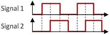

Posted on January 09, 2013 at 16:55
exuse me but i don't see any difference betwen signal using
TIM_TimeBaseStructure.TIM_ClockDivision
= TIM_CKD_DIV1
= TIM_CKD_DIV2
= TIM_CKD_DIV4 It gives the same signal in my oscilloscope How can I change
TIM_ClockDivision
