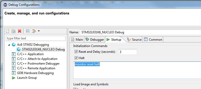

I came across a problem which is about starting a debbuging seession on my System Workbench for stm32 (system Win7 x64). When I'm trying to debug my source code an information appears:
Error in final launch sequence
Failed to execute MI command:
-target-select remote localhost:3333
Error message from debugger back end:
localhost:3333: Connection timed out.

    I tried fixing the problem by deleting my project configuration, uploading cube conf. again, refreshing, cleaning then building and now the output of the console is:

    Error: read version failed
    in procedure 'init'
    in procedure 'ocd_bouncer'
    So there is still a problem with my debugger. Any help will be appreciated.

    A friend told me that one thing might work. After I started my debugging I was pressing the reset button, and when it jumped to the debugger window I stopped pressing the button and surprisingly the project is running properly now. After this occurence I dont have to do such a magic again, everything is working fine now. Enyone knows why?

    This error is due to pendings debug sessions. You launched a new debug session without terminating last one. To resolve this problem follow these steps:
    click Window->Open Perspective->Other->Debug, in the Debug view click verify that all debug session are off (equivalent to terminate).
    Otherwise open ocd is responsible of resetting the board. So, be sure that in Debug Configuration->Start up, Halt is chacked and ''monitor reset halt'' is written.
