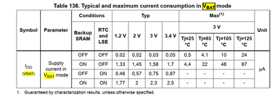

Thx Peter, for quick response.
We have a 10uF cer.cap at VBAT ; and the bad behavior is same, when supplying VBAT from a lab supply : at 3,0V all is fine, when going down to 2,7V "problem" arises.
Although it should work down to 1,2V (vbat) :
‎2024-02-27 5:20 AM

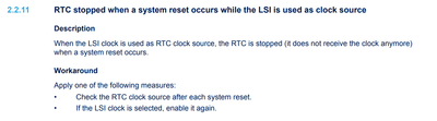

Are you using LSI as source clock for RTC? I guess not.. but better to confirm.
‎2024-02-27 6:31 AM
LSE , only , is used for RTC/time clock.
