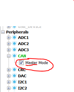

I set up a stm32f103 as master, it worked well. because i received successfully my data with a stm32f407 discovery. But when I set up a stm32f103rct6 as a Slaver Can device, it CAN NOT get data, i using interrupt to get data, all parameters is the same with STM32F407. I dont know why????
In CUBE MX set up for CAN. Stm32f103 have only one CAN, and may be only for Master Device, not for set up as a Slaver. Is it right???

Yes, well the F103 CAN implementation is rather old/limited compared with new iterations of the STM32 designs. It shares resources with the USB.
On F2/F4 there are about 1.5x CAN controllers (ie CAN2 is a parasitic twin)
I'm not sure the Master/Slave context is the same as it might be for SPI or I2C, all CAN nodes can see all bus traffic, you can chose to transmit or not, and selectively filter packets off the wire.
T J
Lead
I set all my devices to Master Mode, they all transmit and receive correctly.

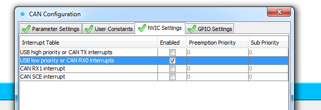

I debug buy ST-Link and see that: My stm32f103 received correctly data in RXFiFo, Over and full Flag are set. But Interrupt did not happen,
I set options for CAN_RX in CubeMX like that: (see figures)
  • In CAN set up, choose: USB low priority or CAN RX0 interrupts (in my code i using FIFO 0 to receive data)
  • in NVIC set up, is the same (auto)
and in my code, i set up as my attach files above
