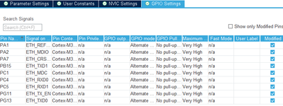

The attachment is my ethernetif.c and eth.c which including MX_ETH_Init and HAL_ETH_MspInit
And STM32H573I-DK configuration is also attached.

another point you should reconfigure the pins assigned to Ethernet as follows :
making sure speed is set to very HIGH and check the board schematics for the right pins physically connected in you Disco (this is the valid pinout configuration for the nucleo H563) .
after doing those modifications you need to check for the Ethernet interrupt and try to debug to make sure your code enters inside it .

Feb 15, 2024 16:02 UTC
Hello @STea
You mention the pinout for ethernet for Nucleo H563.
As mentioned by @EyckHuang, he is using a STM32H573I-DK.
So I think the GPIO pins configuration for Ethernet he indicates in Gateway_H573.ioc is correct and doesn't need to be changed.

Hi @STea  and @Guillaume K  ,
I tried your solution, but it still cannot work. In STM32H573I-DK, the RAM starts from 0x20000000 and length is 640K. I can't set RxDecripSection and TxDecripSection to the position you provided. I set them to 0x20040000 and 0x20040060, respectively.
And as @Guillaume K mentioned, the GPIO pins configuration seems not need to be changed. I only changed Maximum output speed from High to Very High. But still not worked.
