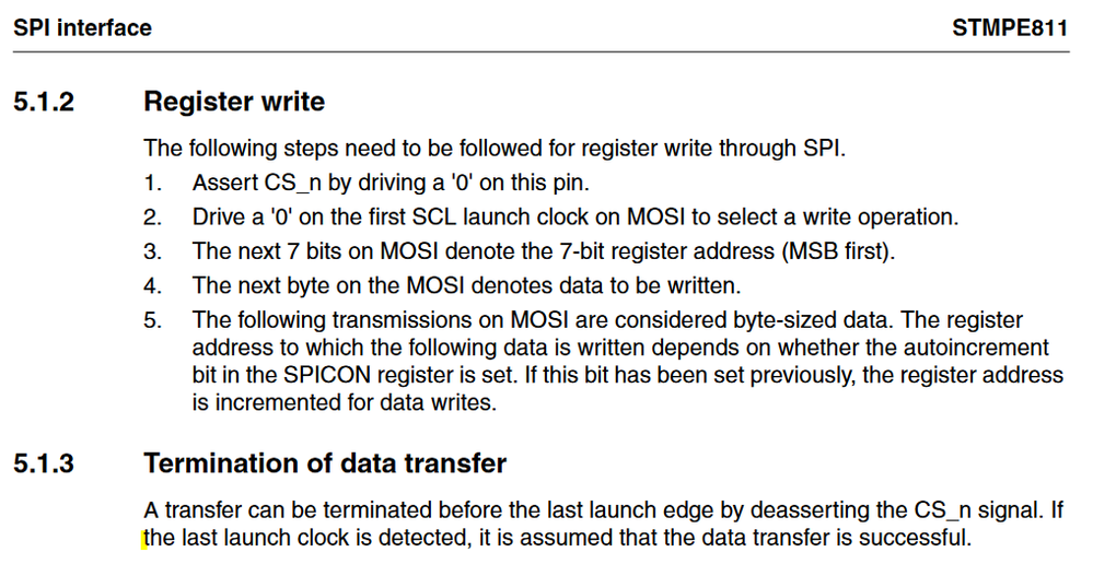

You break the Touch_SPI_WriteReg8     and  Touch_SPI_ReadReg8  transactions, in two pieces by pulling CS  HI state  and low after, in the midle of transaction. Is not correct.
Second observation
Touch_SPI_ReadReg16  Must not been  broken in two 8bit transactions.  Must be continous . means that you push CS to LOW  before transaction  and pull it to HI after transaction.
Regards

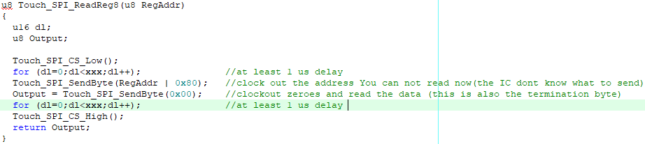

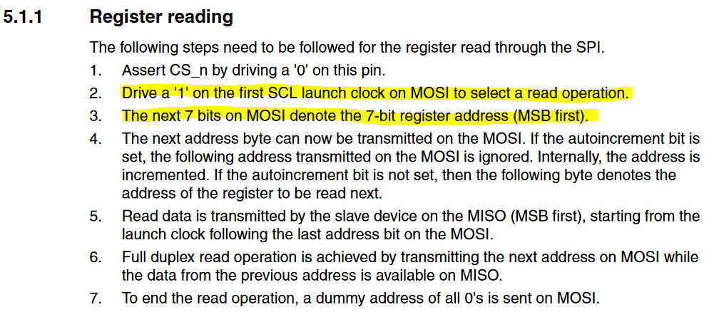

Let 's go gain to Touch_SPI_ReadReg8 function.
The function first gives the address and closes the transaction by write 0. Why to do this without read the data?
At second part reads ''Output2 = Touch_SPI_SendByte(RegAddr | 0x80);'' . This data is useless. You can't read data the same time you give the address .
My suggestion is a read function for 8 bit registers like this (look at the coments)
Finally, I fully agree with
Littell.David
about delays.
