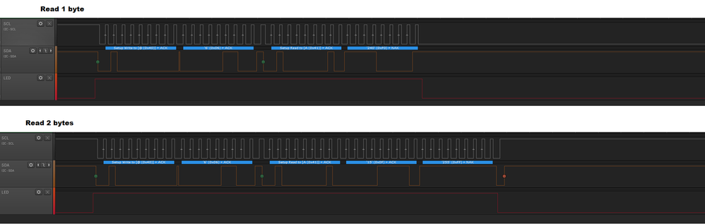

The following screenshots show a 1 byte and 2 bytes data read. The ''Led'' signal is set before the read and clear in ''HAL_I2C_MemRxCpltCallback''
When I read only 1 byte, the clock stays low at the end and the I2C flag is still busy.
This problem doesn't appears when I read 2 or more bytes.

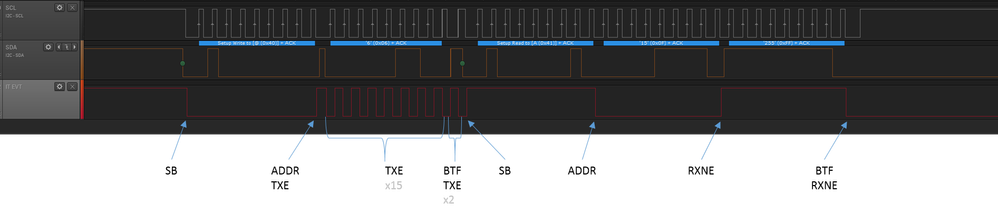

I continued to monitor the I2C driver and found something strange.
On the following screen, the signal ?IT EVT? is a GPIO that is toggle every time I enter ?I2C1_EV_IRQHandler()?
I found strange to enter this often after the address so I monitor the different IT flag and add them on the screenshot.
Hope you could help and fix this problem
