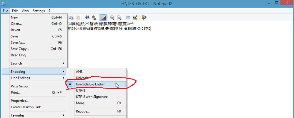

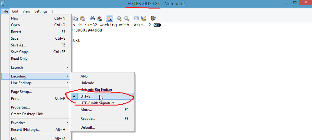

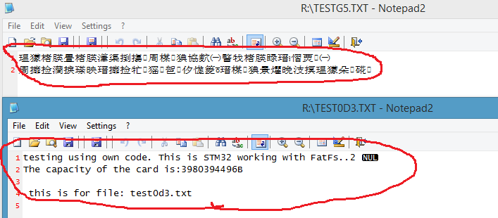

I developed a board using STM32F411 chip with uSD card.The code is generated by cubemx. only add a little bit code in main(). The hardware is OK. I can correctly write a file to sd card. But the weird thing is that the filename accepts 7 chars, not 6 chars. If I use 6 chars in the filename, the character encoding is totally different.
In the testing I only change the filename. I attached two files generated by the chip. 0690X00000605ORQAY.png I can't read the first the characters in the first file. The problem is the encoding of the files are different. 0690X00000605OWQAY.png 0690X00000605LnQAI.png the thing is why the encoding are different. I didn't change anything. Actually I use ANSI in the setting. My question is 1.
why the program uses two different encodings
for the files
just because I use different filenames
? The file with 7 chars in filename always uses utf-8 encoding.
2. how to correctly set the encoding
Actually in the file I specify it to use ANSI encoding, as in ffconf.h. Why the program uses others?
Please help.
The two txt files and the ffconf.h are enclosed as attachment.

I find the problem.
In the code, I set the reading buffer to be a too small size as uint8_t rtext[100]; Actually the data are kind of 134bytes. for unkown reason the program produces very werid behavior. after I change it to rtext[200], everything is working well. The encoding of the file now is ANSI, which is supposed to be. We can control the program to write the text with specific encoding, which is defined in ffconf.h. Again sometime I know the weird behavior should be caused by something else. but it is just hard to figure out. Anyway the good thing is that user can
use cubemx to generate code for microsd
card with little code only in main() For convenience of others, I attached the ioc file. And copy the code from the main() below, one you get a working code for microsd card. Note it is for stm32f4 for other chip, one can do the similar thing in cubemx.
