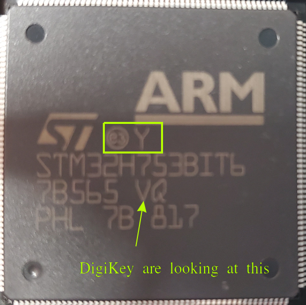

or Digikey https://www.digikey.com/products/en?keywords=STM32H753BIT6 as it says 480MHz but the device that came was Rev Y and can only run at 400MHz.

We didn't updated the part number when changing from revision Y to revision V. The revision is shown on package top marking.

DigiKey initially said that they have Rev V but see the below photo they sent from stock and we marked it for them, as per the datasheet this IC is Rev Y, DigiKey are looking at the bottom V which stands for something else. After we pointed this to DigiKey, they came back and said that yes its Rev Y and there was some confusion and cant order Rev V parts. But the problem now is that no supplier can supply Rev V, so basically we have no place to order Rev V parts.
can ST help us get the Rev V parts as its causing a lot of problems to get the right part numbers.

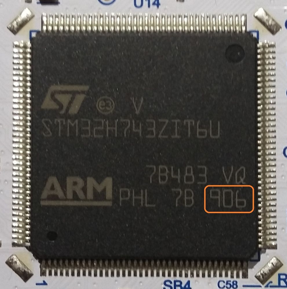

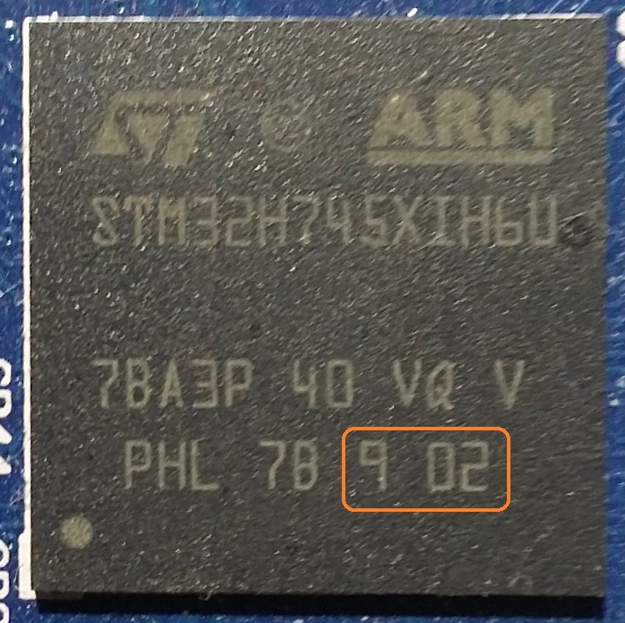

Use the production date code. You definitely don't want any 2018 product.
Here 2019 Week 6

STM32H745XIH6U 2019 Week 2

I don't know what the cut off date was for Y-step silicon, but I've got X-step devices from the French facility dating from 2018 Week 20, and V-step devices from the first weeks in 2019.
The Production Date information should be all over the reels, boxes and packaging.
