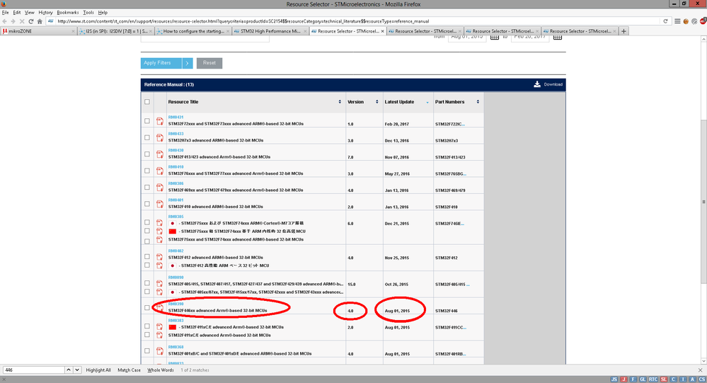

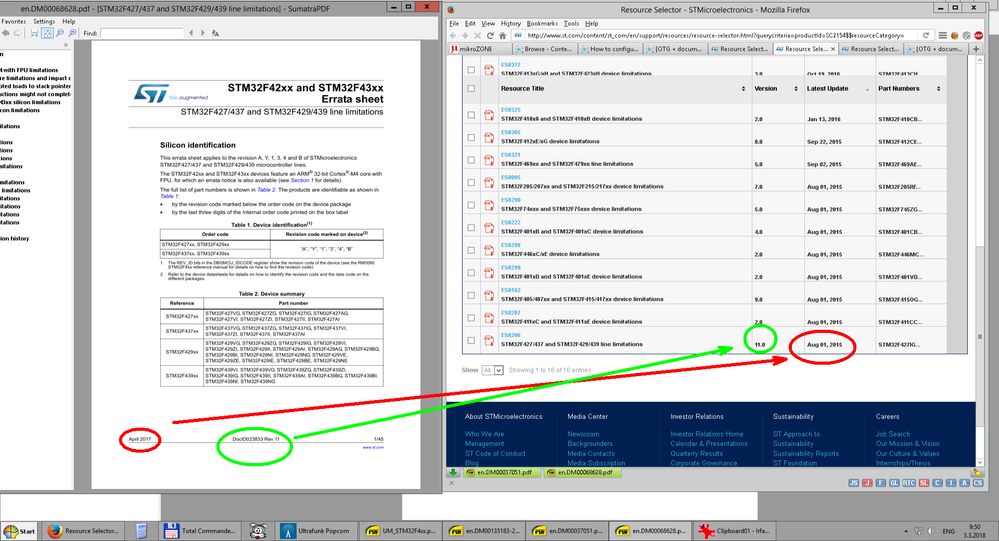

Posted on March 03, 2018 at 09:41
Hi
garsi.khouloud
could the date of RM change also be updated in the Resources selector?
Thanks,
Jan
[EDIT] PS. This appears to be a more widespread problem...
https://community.st.com/0D50X00009XkaRZSAZ
[EDIT2] Yes it is... a random example, I checked half a dozen RM and DS and ES and *all* had incorrect date...
In the above linked thread I'll discuss the importance of maintaining this information properly.

Khouloud GARSI
Posted on April 24, 2018 at 20:33
Hello Jan,
I have two good news
1. The
http://www.st.com/content/ccc/resource/technical/document/reference_manual/3d/6d/5a/66/b4/99/40/d4/DM00031020.pdf/files/DM00031020.pdf/jcr:content/translations/en.DM00031020.pdf
is updated and now available on ST website.
In this discussion, two open points are still under discussion. Otherwise, all other issues were discussed and fixed, and the 'Interrupt hierarchy' figure was fully reworked.
2. The 'Latest update' column in the 'Resource Selector' is updated correctly now.
We really thank you for highlighting all encountered issues through our Forum, this helps us to enhance the quality of our documents.
Khouloud.
