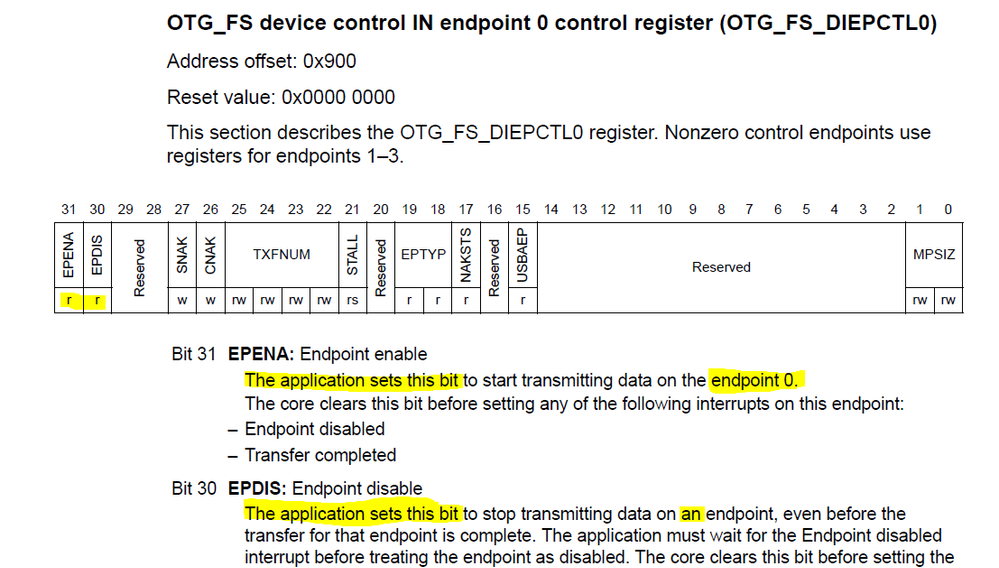

In [STM32Cube_FW_F4_V1.16.0]\Drivers\STM32F4xx_HAL_Driver\Src\stm32f4xx_ll_usb.c  USB_EPSetStall(), the following can be seen:
USBx_INEP(ep->num)->DIEPCTL &= ~(USB_OTG_DIEPCTL_EPDIS);
(and the same for DOEPCTL).
However, according to respective RM, EPDIS bit in both DIEPCTL and DOEPCTL are rs (read-set) and read-only for endpoint 0, i.e. writing 0 has no effect.
Comment, please.

    Hello!
    You have right.
    Before set STALL bit, for non isochronous (and non control) IN and OUT EPs, according to manual must disable first the EP by set EPDIS.
    Inside USB_EPSetStall() function,STALL bit is set without disabling the EP first.
    From an other point of view, this is an LL driver and normaly USB_EPSetStall()  func should sets the STALL bit only. There are also other functions for disabling the EP.(USB_DeactivateEndpoint(..),..).
    In my opinion the next code is redundant (also for the OUT EP) and of course, as you wrote, has no effect.
    Take a look  also at ctrl IN endpoint. It is from same RM.(needs some correction also)

    Hi Jan,
    I confirm this misalignment and I have reported it internally.
    By the way, all your reported requests (regarding USB documentation/drivers...) are well received. We will treat all of them one by one and come back to you with an answer ASAP.
